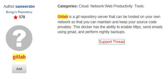

i've tried to update the gitlab docker today and it's not working anymore.
At the end of the docker update/install i get the following errors:
sh: -c: line 0: unexpected EOF while looking for matching ``'
sh: -c: line 1: syntax error: unexpected end of file
The Icon in CommunityApps is also missing (see screenshot).
I think something is broken in the repository....
