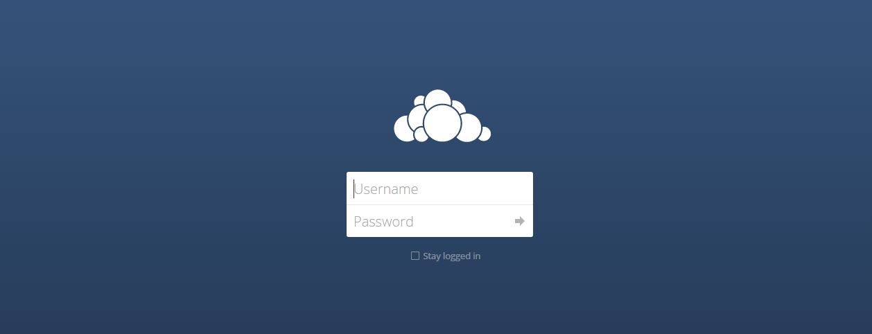

I have a linuxserver.io apache revrse proxy running.  I have installed the Bungy owncloud docker.  I am attaching screenshots to see if anyone can suggest what I need to change to fix my issue.  Have you seen the attached screenshots before.  The normal (blue) screenshot is when I am accessing owncloud using http://server.com:8000.
The white screen shot is when I access owncloud using https://server.com/owncloud.  Not only is it white but I cannot login to owncloud.
Thanks
Bill
Yeah, i've seen that before. You need to set up your owncloud container to serve the static files on /owncloud.
Add or edit these lines in your config.php file
'overwritewebroot' => 'owncloud',
'overwrite.cli.url' => 'https://server.com/owncloud',
Then reboot the owncloud container and you should be good to go.

Yeah, there was a misunderstanding there. All you have to do is add or edit these lines inside of your config.php file:
Make sure you replace server.com with your hostname.
Thanks for being so quick is this code correct for my linuxserver.io Apache reverse proxy?
Also my code in Apache default.conf is
<Location /owncloud>
ProxyPass http://192.168.2.97:8000
ReverseProxyPass http://192.168.2.97:8000
</Location>
Thanks a bunch
Yeah, your reverse proxy looks like it's working correctly. Otherwise you wouldn't get the white screen with the login prompt at all.
So the screen is normal thanks for that!!  I also had to add
'overwriteprotocol' => 'https',
that allowed me to log on properly.
Thanks very much!!!!
