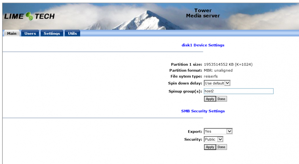

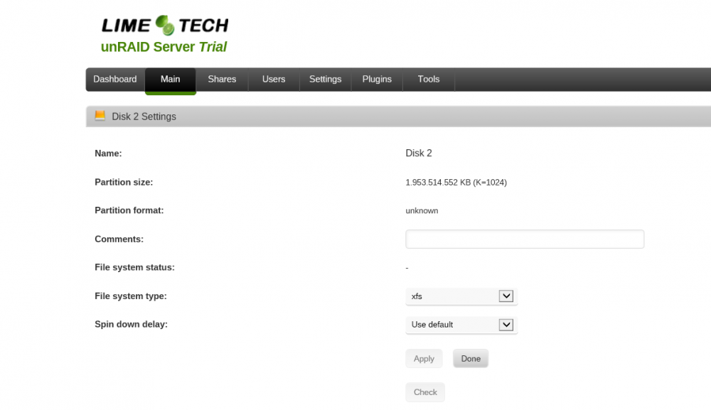

I've installed the latest unraid v6 on a spare laptop. I formatted the ssd disk, and it defaults to XFS.
My V5 unraid server which i plan to update at some moment in time, is formatted as ReiserFS if i'm correct?
What is the upgrade plan for XFS when coming from v5? Is there some conversion tool? Or do i have to empty every drive and reformat and put the data back?
Yes v5 only supports Reiserfs.
Note that v6 still supports Reiserfs - it is just that the default is now XFS (with an option for BTRFS as well).  It is perfectly possible in v6 for different disks to be on any mix of the supported file system types.
Switching the file system type for existing disks already containing data DOES need to go through the empty/switch route if you want to convert a disk from Reiserfs to XFS.
There's no conversion tool => but the simple fact is there's also no compelling need to switch existing disks to XFS.
If you WANT to do that, then there are several approaches ...
=>  Add a new disk in XFS format; copy all the data from an RFS disk; then reformat the RFS disk ... and repeat this basic process until all are converted
=>  Ensure all your backups are up-to-date; then reformat all of your array disks to XFS; and then copy all your data back to the server from your backups
=>  Build an entirely new server with XFS disks; then copy everything from your old server to the new one
etc.
