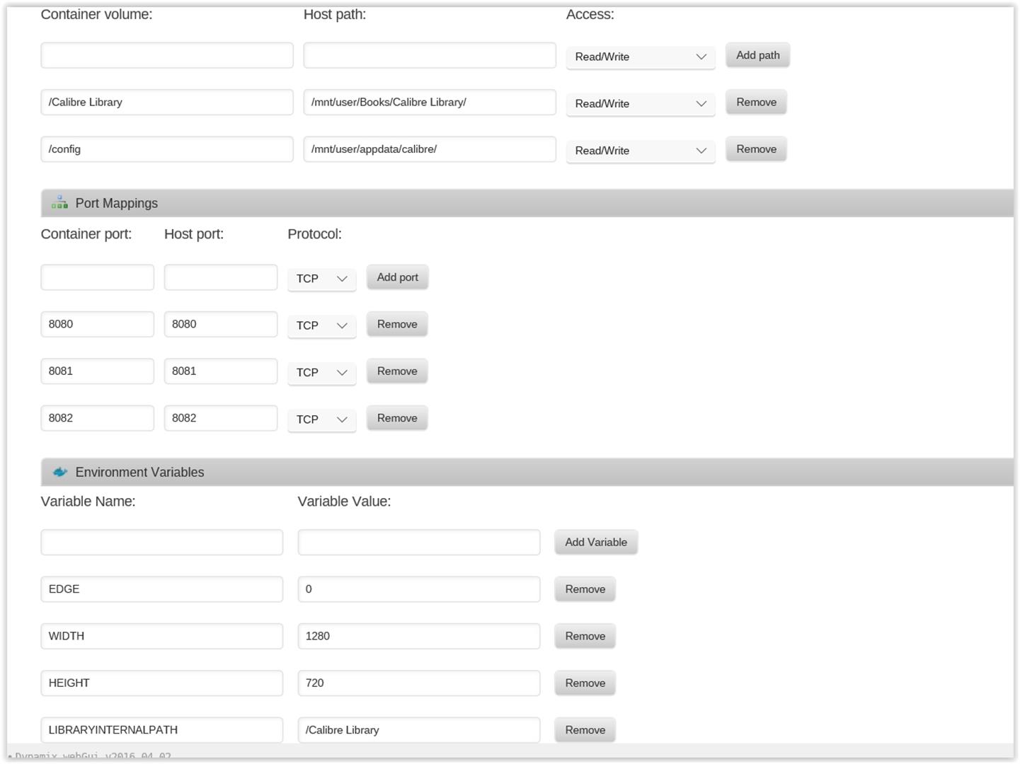

I need some help with RDP-Calibre
I installed and it loads fine, I have a large library that I want  stored outside of the container. I added the new path and added the variable like the instructions said but as soon as I do it shows up as an orphaned image.
Can someone please take a look and tell me what I did wrong?

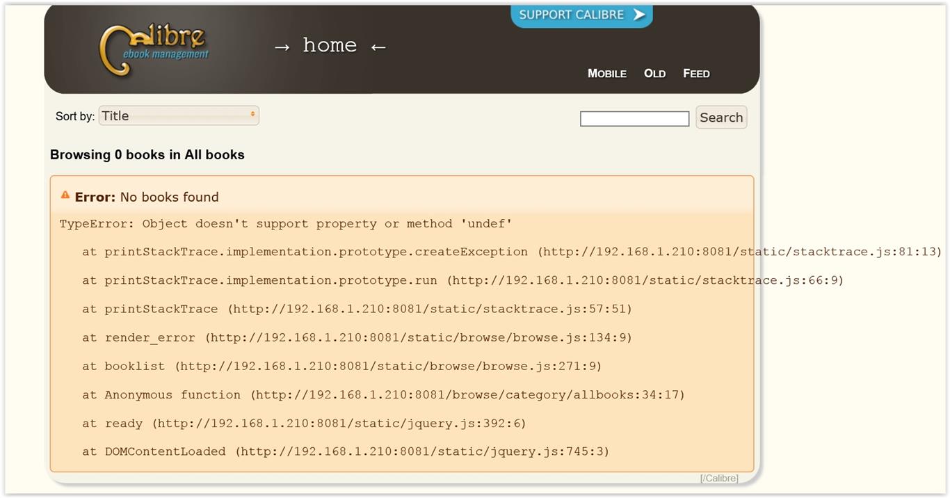

Ok I spoke a little too soon, but this is a different problem. Going to 8080 and selecting calibre works fine, going to 8081 it still thinks the library is at /config so it finds no books and causes errors. Where can I fix this?
You'll have to wait for aptalca or someone else who knows this app to pipe in

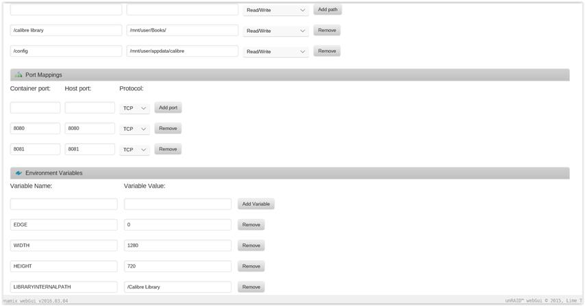

-Edit to add screenshot incase it helps
Thanks will do
Can you add a screenshot of your new settings?
Calibre server (8081) should open the library at the address defined by the libraryinternalpath variable
The books are imported into the config folder, not inside the container. Why don't you set the config folder to where you want to keep the library?

Pretty sure the space in the path is causing issues.
Try setting the libraryinternalpath to "/Calibre\ Library" without the quotes. Leave the mount points as is
