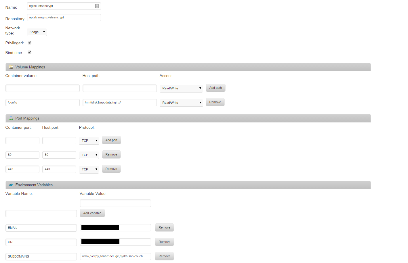

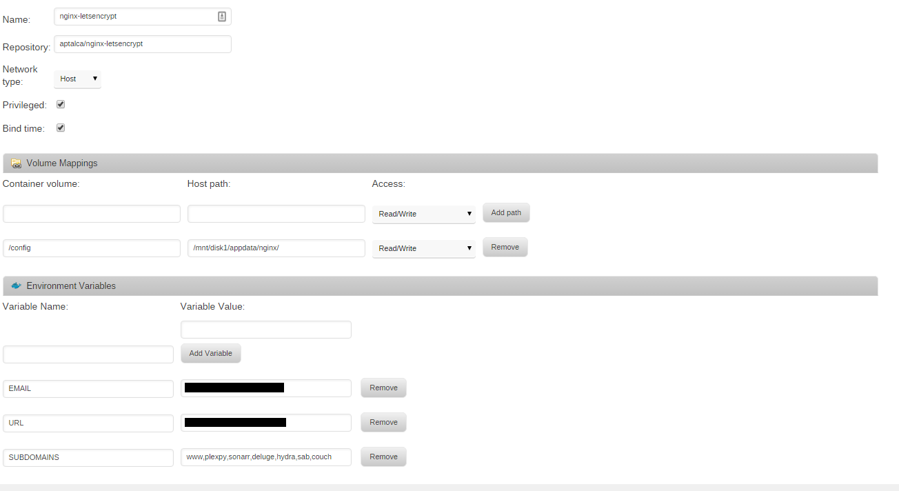

Hey, so I'm trying to get Nginx-LetsEncrypt set up but it refuses to start if the Network type is set to Bridge. No logs are generated. Starts if Network type is set to Host or None but the logs say that Nginx has failed. Any ideas?
Thanks in advance

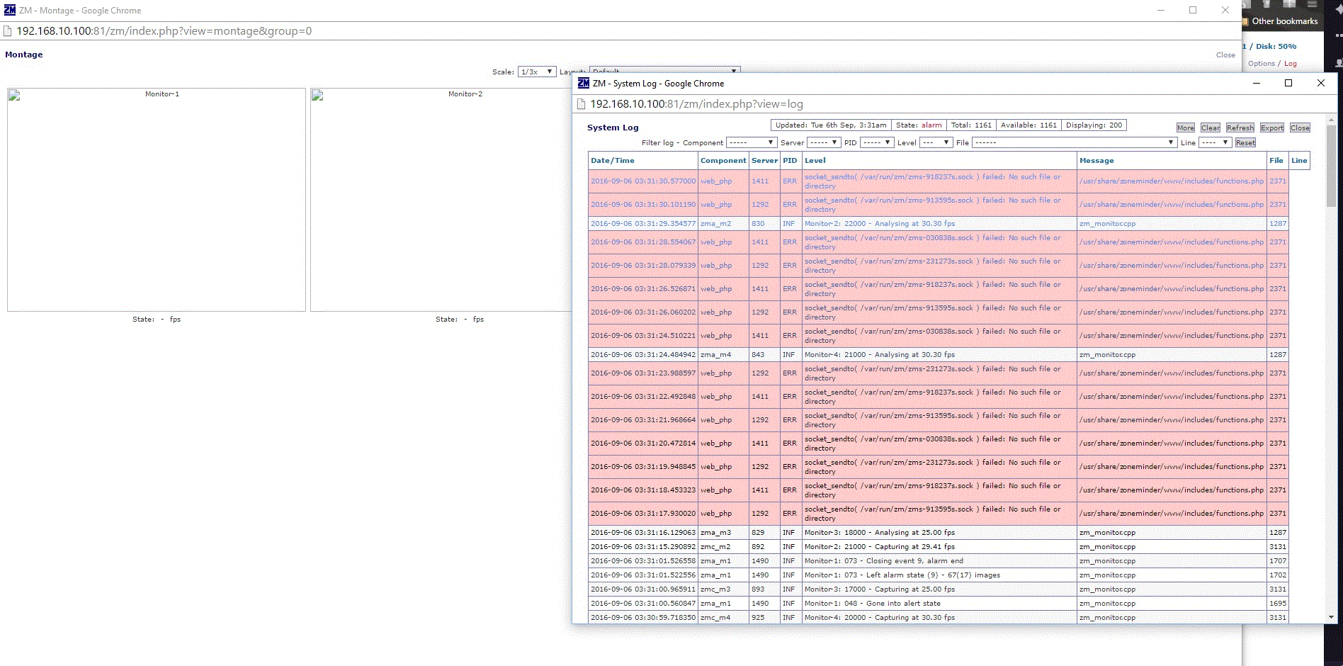

issues with live viewing off cams it seems to recorded fine and images open fine but live view has no image i get errors in logs of
zmwatch 776 err shared data size conflict file zmwatch.pl ?
any help will be great
Thanks in advance
Post a screenshot of your settings and the docker log please
Are you sure that the ports you are trying to forward in bridge mode not used for anything else?
Which zoneminder container?
Did you follow the instructions on the docker hub page? There is a specific setting for fixing live view in v1.29
Thanks in advance

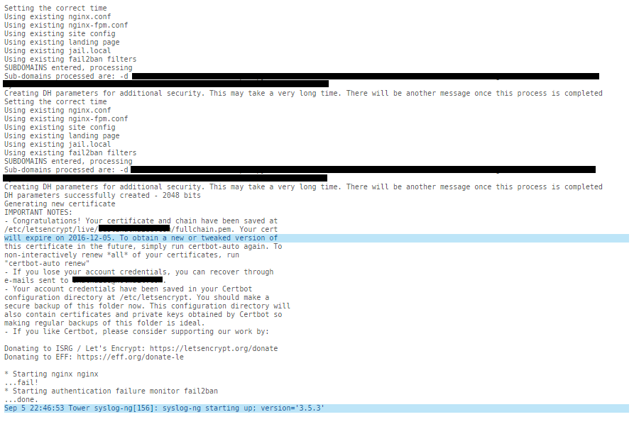

Ports arnt being being used for anything else. No logs are generated when in Bridge mode
Not that I have any clue about this container or its setup, but host port 80 is definitely already in use (by unRaid's emhttp) unless you've changed the port unRaid operates on.
That is definitely your problem. Try setting the host port to 81 and have your router port forward from 80 to 81.
that was it, i'm a big dumb dumb. thanks!
i was running 1.28.1 version not the 1.29 , could that be issue?
after update same thing , images are perfect but no video stream
update i followed extra set up on github after 1 min all of the streams kicked in :) thank you
next issue is ptz on my camera its basic ipcam what do i need to make it control the camera on Control Device and Control Address ? its mainly set up as ONVIF Camera
any examples?
Thanks in advance
Port 80 is used for unraid's web gui. That may be the problem.
I also see in that log that most of the config files are present, but it creates a new dhparams file and gets a new certificate. Are you manually deleting certain files?
Also in host mode nginx fails to start. Nginx error log should tell you why.
Are you on 6.1.9? If so, use a /mnt/cache location for the config folder
Edit: didn't realize others already commented and your issue is fixed, oops ;)
