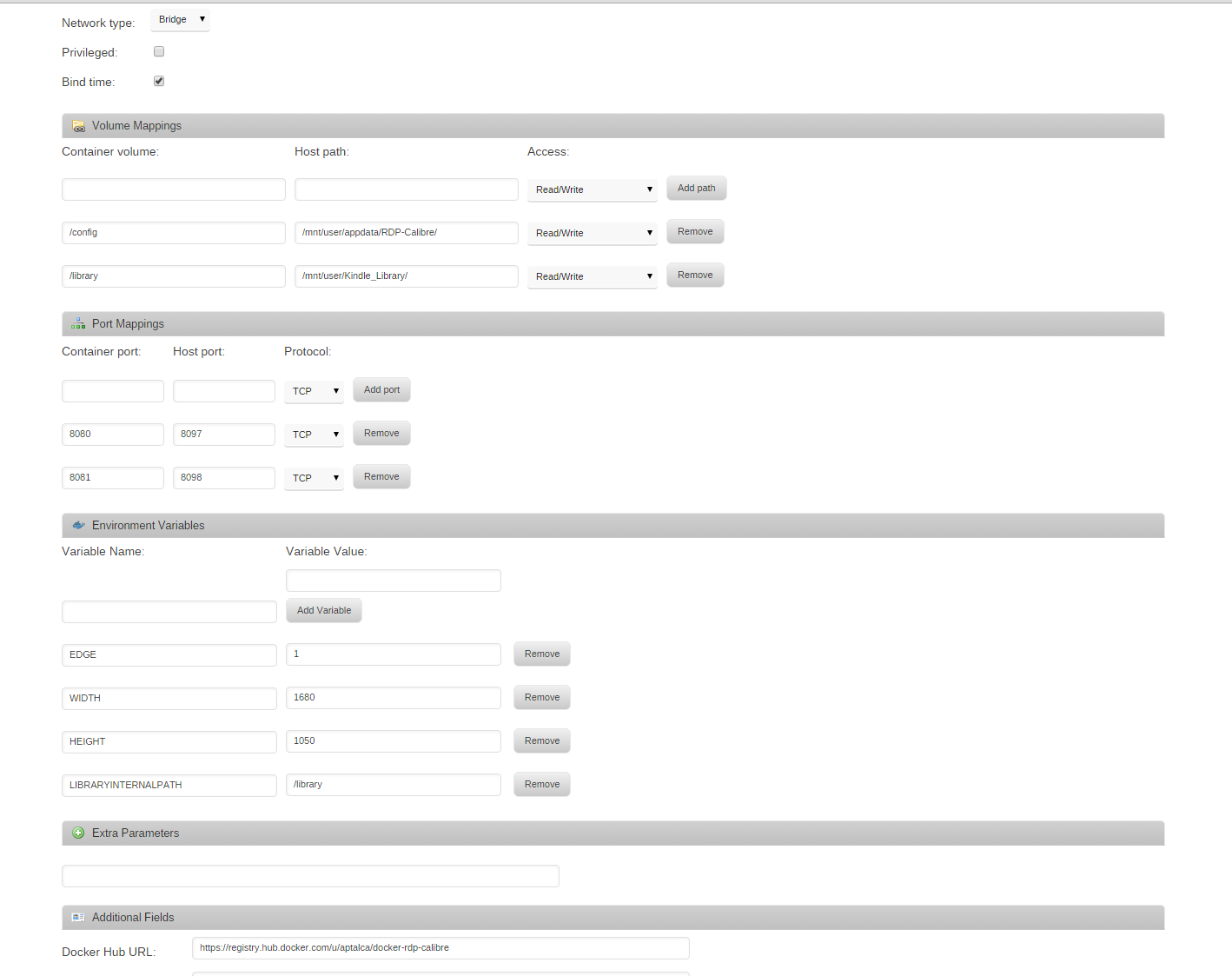

After further testing I found what's happening.
I had the Environment Variable 'EDGE' set to 1. The latest calibre release 2.67 is broken something in the app.
Set EDGE back to 0, version 2.33, and it works again.

Just had the same issue as dheg, Calibre 2.67 update breaks the VNC connection somehow (though I also have a custom library set up).
Trying EDGE=0.
Update 1: Worked just like dheg's. Probably a critical fault with the 2.67 release itself, vice the VNC setup, now that I think about it.

Yup,  broke here too. Didn't get a chance to figure out the cause yet. You can change edge to 0 in the meantime
