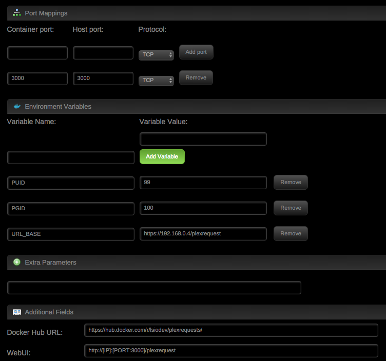

Hey CHBMB, its me again. I followed these instructions and I am getting an "unknown path" error when i try to access the web gui (local ip or public domain name)
Try clearing your browser cache, and restarting both apps.  I'm afraid I don't use this version of plexrequests, but unless Aptalca has changed something, it should work.
I should have specified, I also use the linuxserver docker. I posted in this thread because you had previously answered a similar question in this thread. In any case I will do a server restart and some other basic stuff to see if that fixes it. Thanks! :)
Probably best not to bother that nice man aptalca with this then.....  ;)

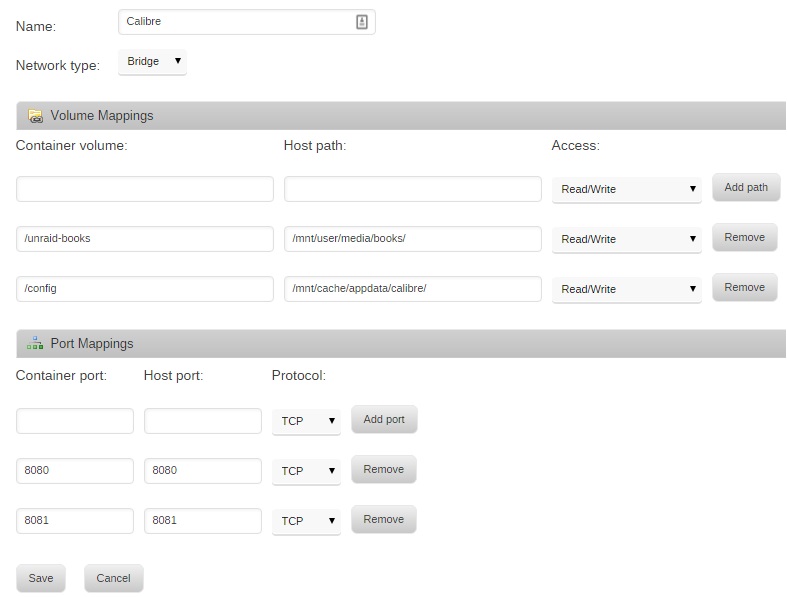

hi aptalca,
the calibre web server doesn't work, it loads and when clicking on 'All books', it shows the next errror message:
TypeError: this.undef is not a function

hi aptalca,

Can you post a screenshot of your settings and also a log?
I'm assuming you set a custom library location and it may not have been set up correctly
Attached are my settings and log.
When you launched calibre the first time, did you select /config or /unraid-books as the library location. If latter, did you set the environment variable LIBRARYINTERNALPATH?
To be honest, I don't remember...  Shall I start from scratch?
Sent from my SM-G901F using Tapatalk
