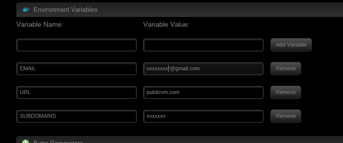

In using Nginx-letsencrypt
I'm kind of new yo create domains, i do have a ddns name for my home router at http://www.dnsexit.com/, this one I have xxxxx.publicvm.com
How shall I put in this to the docker config to use with letsencrypt?
see image attached
log from the docker
see image attached

letsencrypt expects you to have full control over whatever url you put in. In the case of dynamic dns, you do not have control over the actual domain: publicvm.com
In that case put in xxxxxx.publicvm.com as the URL and leave the subdomains as is (default is www). With that, letsencrypt will create a certificate that covers xxxxxx.publicvm.com and www.xxxxxx.publicvm.com, both of which you have control over.
