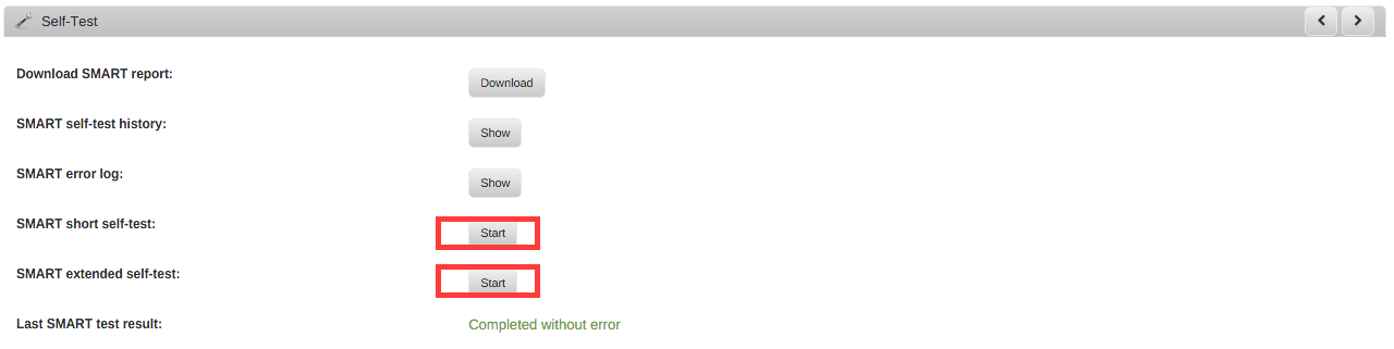

Another 2 Seagate 8TB drives successfully through 3 cycles of preclear using Brian's "Faster" preclear script. Thats 6 drives now across what is likely 4 batches and not even a blip to speak of AND performance has been unnoticeable from my WD Red 3TB NAS PMR drives!
Just running a FINAL long S.M.A.R.T test and then into deployment mode they go!!

1. Install the preclear Plugin.
2. Download the "Faster" prelcear script and put it in the dir as instructed by the preclear Plugin instructions (remembering to rename it).
3. Install the disks.
4. Execute a S.M.A.R.T. Short test (See screenshot).
5. Execute the preclear by clicking on the preclear icon on the Main Tab for EACH of your disks using the following settings:
- 3 cycles*;
- enable fast post read.
*note that 3 cycles will take a LONG time (as I note in my results and posts above) but it is worth it. I would also make sure that your server can be uninterrupted during this time. Interrupting a preclear is unfortunately something I have done and it can potentially harm your disks.
6. Live your life while you wait for the preclear cycles to complete. :)
7. Post the results of the preclear AND S.M.A.R.T reports on the Forum if you need help to interpret them.
8. Execute a S.M.A.R.T. Long (Extended) test** (See screenshot).
**note that the S.M.A.R.T Long (Extended) Test will also take a while but no way near as long as a preclear cycle.
9. Follow step 7 again if you need to.
10. Once you're happy, configure your settings (if you have not done so already) and then add them to array slots and start to your Array! The preclear script adds a flag to the drive which indicates to unRAID that a clear has occurred and will NOT attempt to do it again.
You asked specifically how to perform a Long (Extended) S.M.A.R.T test. Once the drives are installed and you've booted into unRAID click on the disk name (Which is a link - e.g Disk 1) which will bring up Disk Settings. In the third section down it is called "Self Test" In there you can press the button to execute the test you want to perform and also view the S.M.A.R.T attributes, download and view S.M.A.R.T and test reports etc (As noted see screenshot for help).
Like I mentioned at the start of the post, if you have any questions read / post in the forum. If the answer isn't here it isn't anywhere!
Good Luck!
