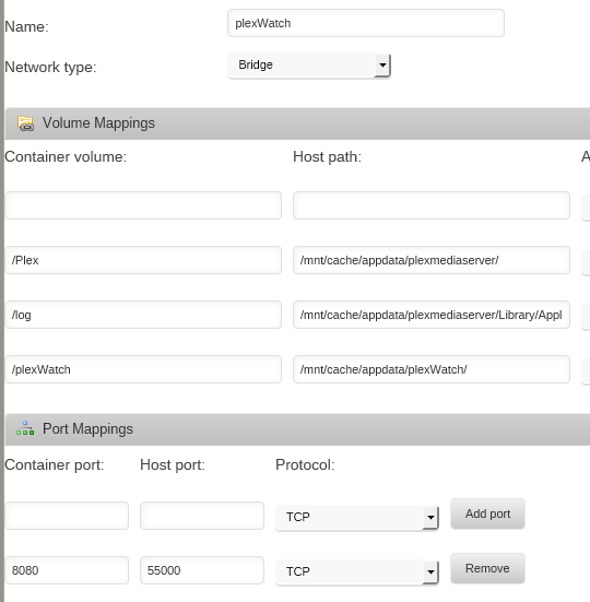

I too had not been able to get PlexWatch running before but today's attempts ended in success so keep trying :P
another thing I did different this time was to use direct path to cache drive rather than user share path.
my docker settings.
So you are running in bridge mode, which can work, but requires additional modifications to the config files.  For people having problems, please use HOST MODE ONLY and DO NOT EDIT ANYTHING other than the username/password in the two config files.  It really does work :)

my docker settings.
Any chance you could post content of the 2 config files? Obviously replace your username and password.

my docker settings.

If you are running anything else on port 8080 (like unMenu) then plexWatch won't work in Host mode. That's why I switched to Bridge so I could map plexWatch to a different port number.
