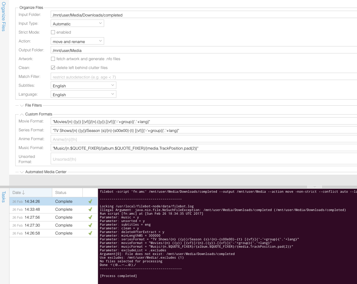

I tried this:
docker run -it -v $PWD:/mnt/user/Media -v data:/data -p 5452:5452 rednoah/filebot:node fn:sysinfo
But when i run the script it doesn't find the path to media.
