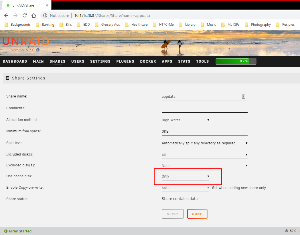

My original configuration didn't use or have cache at all. Plex Config was set to /mnt/user/appdata/plex. Appdata (and all other shares) was configured to not use cache. After updating unRaid to 6.7.0, the database corruption started.
While trying to find a fix, I found this link: https://github.com/binhex/documentation/blob/master/docker/faq/unraid.md. Q/A 7 seemed to describe the problem...see below.
I rolled unRaid back to 6.6.7, added a single 240GB SSD cache drive, set appdata to "Cache Only", deleted the Plex folder in appdata, and reinstalled Plex. I ran this configuration for two weeks to make sure it was stable, then updated unRaid to 6.7.0 on June 13th. It has been one week today, running under 6.7.0, and I haven't has a single problem.
I'm running several of the "Community Applications" plug-ins, and several more of the "Dynamix" plug-ins. I haven't made any changes to the plug-ins. I use "CA Backup / Restore" to backup my appdata daily, and haven't made any changes to it either.
Hope this helps...

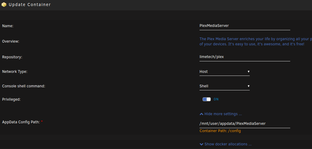

Above you show 'split level' set to 'auto split any directory' - do you think it was like that before, when you had appdata existing only on array?  Also, do you know if appdata/plex directory specifically existed on multiple array disks?
What I'd like to ask you to do is leave all config exactly the way it is, except, change the Plex appdata mapping from:
/mnt/cache/appdata/plex
to
By changing the mapping from /mnt/cache to /mnt/user it should give more information revealing where the problem might be.
Yes, that's how all my shares are configured. Yes, appdata was spread across all 14 of my array drives.
to
Sorry :(. It's not that I don't want to, but I've finally got it working, and don't want to invest any more downtime, in the event it starts failing again. I hope you can understand this from my perspective.

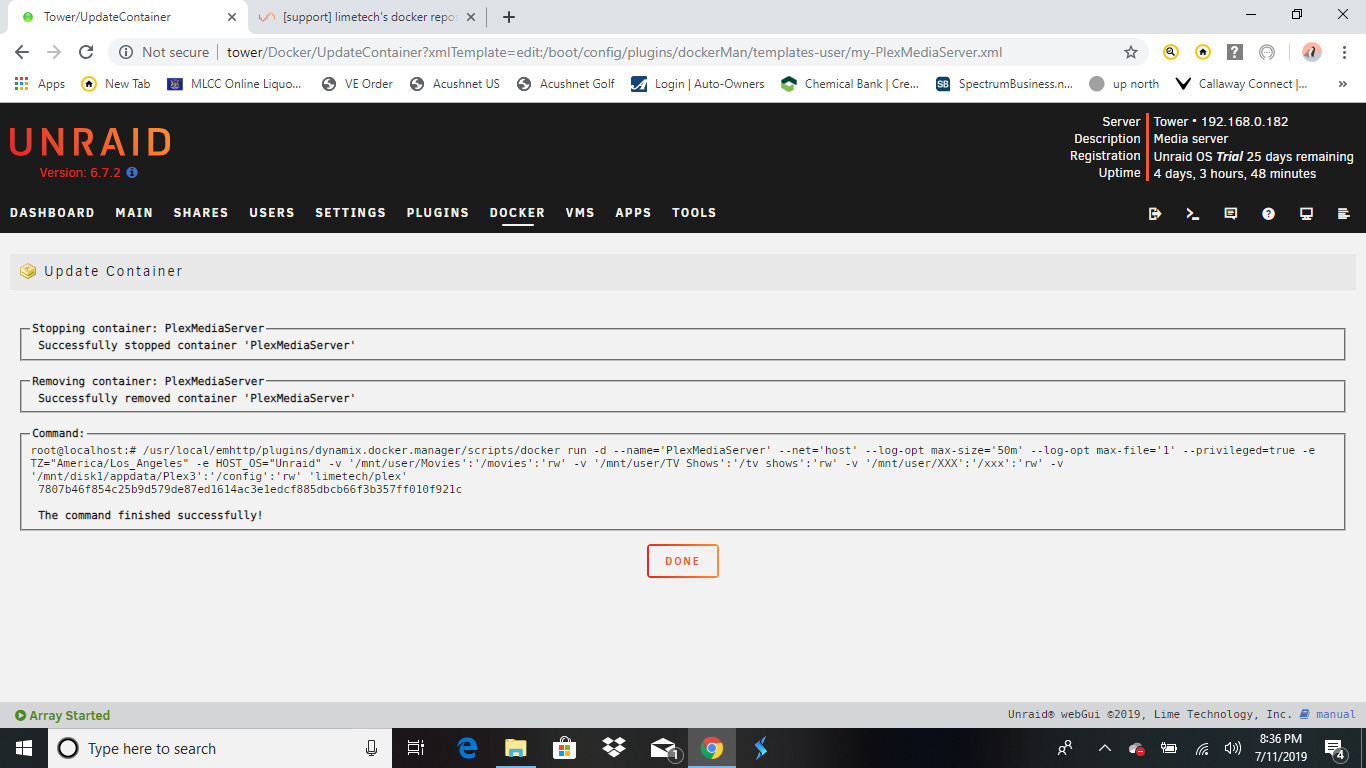

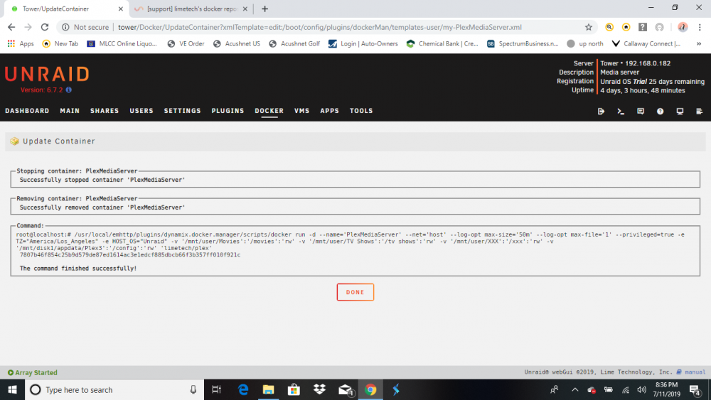

Here's the docker run command:
root@localhost:# /usr/local/emhttp/plugins/dynamix.docker.manager/scripts/docker run -d --name='PlexMediaServer' --net='host' --privileged=true -e TZ="America/New_York" -e HOST_OS="Unraid" -v '/mnt/user/appdata/PlexMediaServer':'/config':'rw' 'limetech/plex'
35c329cdd6383bd03c84f10b9a57130ed4d1102ae2cf9d5d8af77dfacb924eae

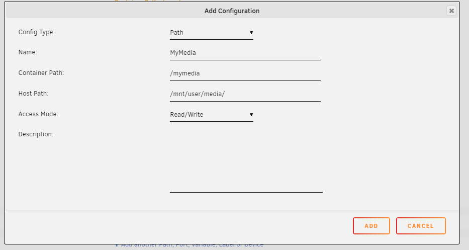

Edit the app, and add another path mapping.  Something like host path of /movies mapped to /mnt/user/movies
You will then see your movies within Plex at /movies

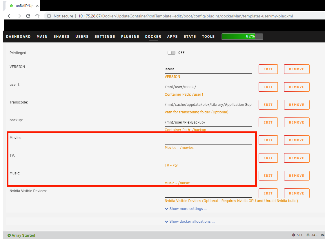

20 minutes ago, itlists said:
Hello,
New unRaid Plex user running into an issue.
I'm trying to add my libraries to the Plex server. When I go to select folders and browse to /mnt, its empty. My share is located /mnt/user/Media. However, in the Plex server gui, /mnt is empty. In fact, all root level folders are empty.
What am I doing wrong?
Any help is appreciated! Thanks
You don't want to use /mnt. When you install Plex you have the following screen...
Notice the three in red? These are the paths you want to use in Plex. You want /Movies for your movies, /TV for your TV shows, /Music for your music, etc. I add a path "/user1" that points to /mnt/user/media where all my media folders are. On my system, Plex looks like...
On my system, it looks like this...
I hope this helps :)
This is what I see when editing the plex docker:
I'm using the linuxserver.io container. You're using the Limetech container. Not a big difference. Limetech has less options to screw up, LOL. At the bottom of your screen you have the "Add another Path, Port, Variable, Label or Device" option. Click on that and you can add the path(s) you need, pointing to your actual media. It'll look like the next screenshot. The "Config Type" defaults to "Path", so leave it. "Name" can be anything you want. "Container Path" is what you'll see in Plex. Be sure to have the leading slash. "Host Path" is a drop down you can use to drill down to the path on your array path. If it helps, it's very similar to mapping a network drive in windows. You want to map your host path (/mnt/user/whatever) to a local path (/mymedia in this example) that Plex will see.
Thanks all for your help!
Got it working!!
Edited by itlists
Glad to help :)
Ok, I believe I am asking for the right thing, still a newb with unraid and how dockers and stuff work. Any chance the plex docker get updated to 1.16.1.1291 soon. Plex just had a major update to this version. Live guide data was changed to a new provider with this update.
If you want to always run the latest, greatest, (and occasionally bug ridden) version of Plex, then you should instead ru the version from linuxserver.io
