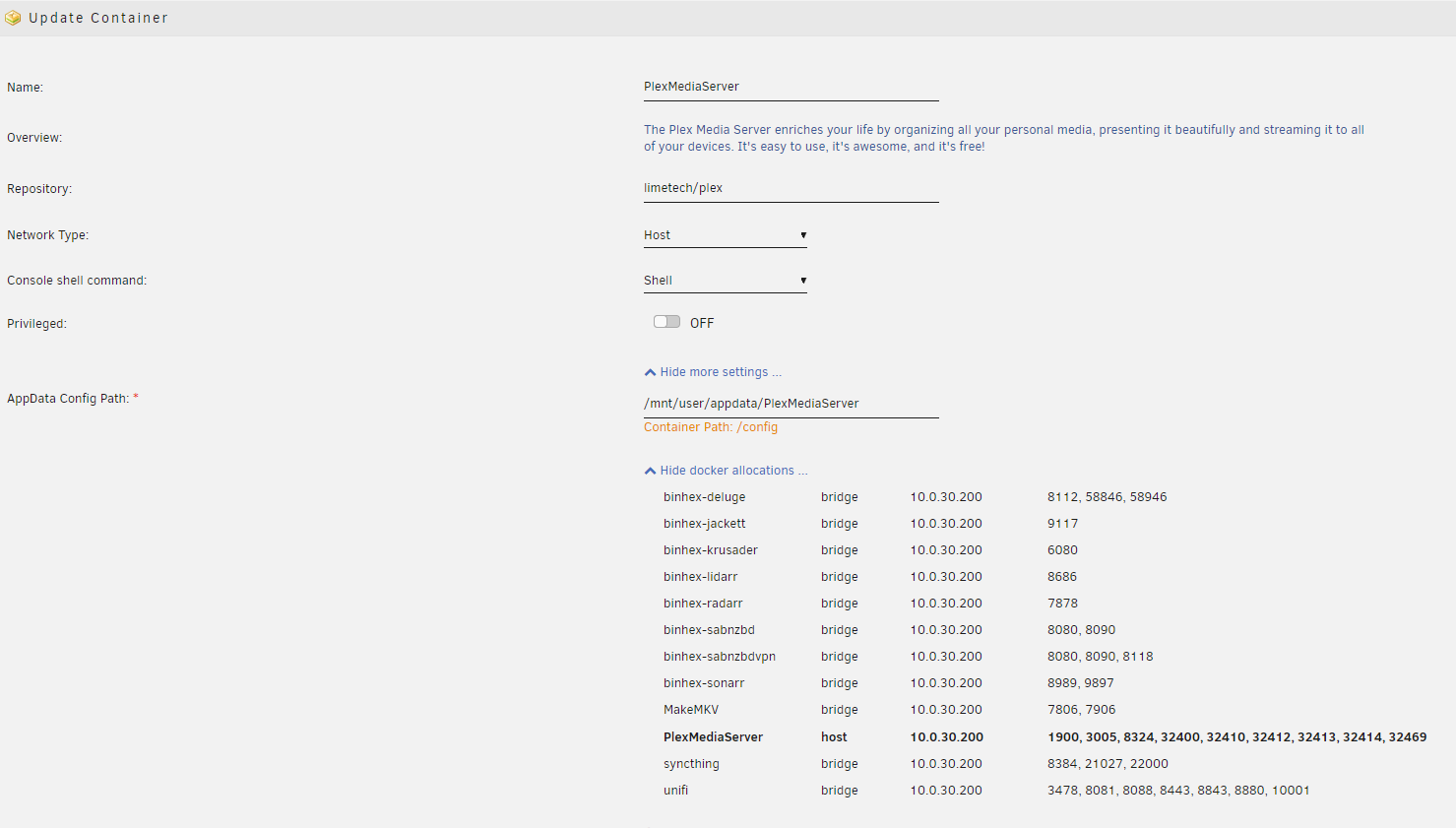

Could you try stanarad - without vlans - just to see if its your network? Also, did you host the docker in br0 or bridge? I would take br0.
I take it you mean standard?  That would require a tremendous amount of reconfiguring.
Currently, the docker is set to host (as per everyone's recommendations).
If I set it to bridge, then I would have to manually enter all of the tcp and udp addresses, correct?
never used host, only bridge or br0.
You just need to unvlan your pc and plex, shouldnt be that much work?!
ports should come from the run cmd, and or docker template.
Im not sure about host, but i know in bridge it cant talk to some things. Thats why i use br0 for all dockers which communicate with something.

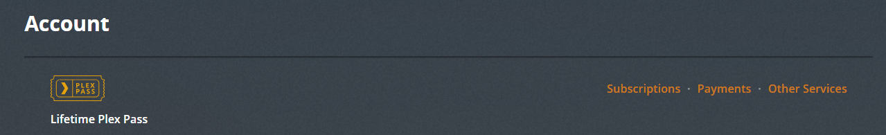

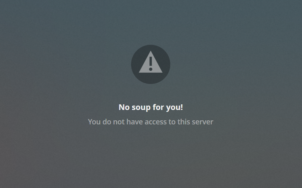

On 3/24/2019 at 5:44 PM, arombo said:
I'm also on that release on chrome. I've disabled my adblockers and video blockers, but the web interface is still not functioning correctly. If I restart the plex docker it works fine on first connection. If I then leave the page and come back it will be in the buggy state. Thinking about moving to a different plex repo to see if it's isolated to the docker or just to me.
Is this what you mean?
I am seeing this when I poke around pages using the local webui (http://<Unraid IP>:32400/web/index.html# ) for example. But I don't see the same behavior when accessing through cloud access. Not sure if it's a container issue or plex issue yet. @eschultz maybe an idea?
Good way to reproduce it:
Log into - http://<Unraid IP>:32400/web/index.html#
On left hand side, click "Settings" under "Manage"
EDIT: If I manually log out of plex all together in my browser, and sign back in, it works again.
But then, if I click, for example, Account
Then click "other services"
I am opened to a Plex webpage. If I click back with my mouse to the previous page, the session goes Soup Nazi again.
EDIT 2: Only happening in Chrome. Firefox seems to be working okay. I suspect it's a browser issue.
