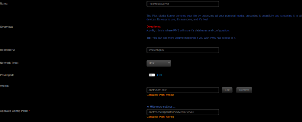

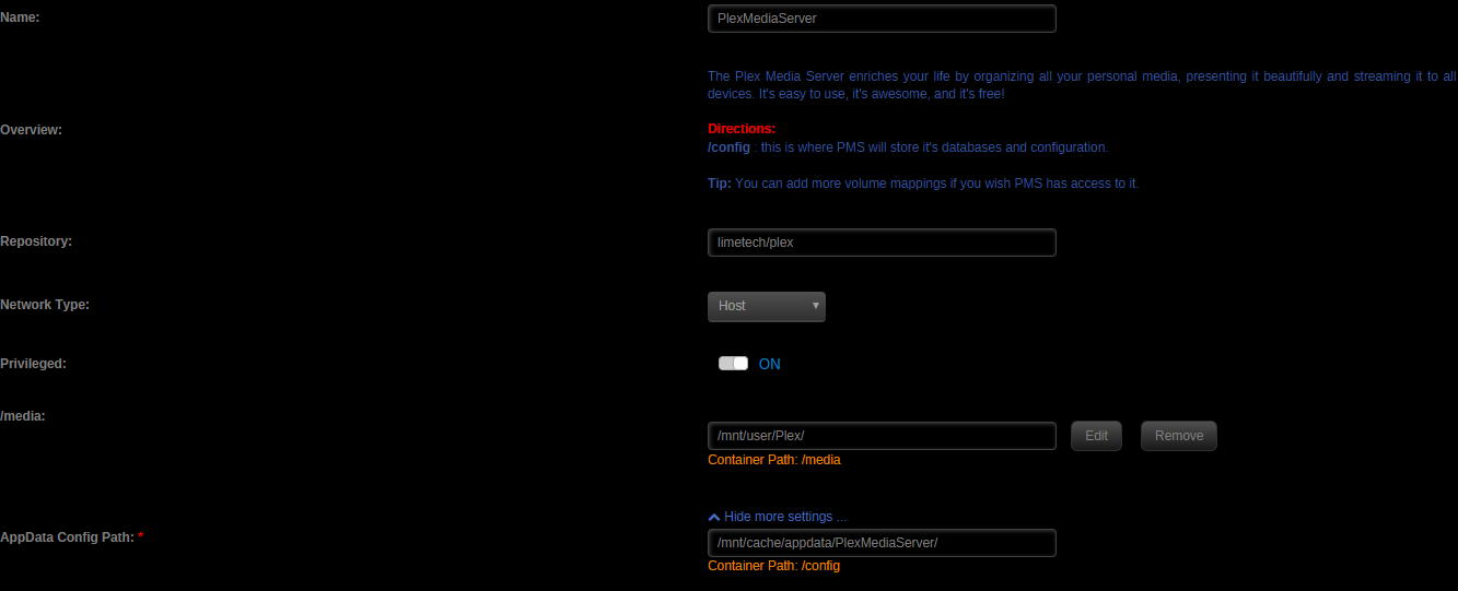

So I was using another version of plex and was having issues with it and saw the limetech version so I removed the plexmedia folder at my appdata/plexmediaserver directory. After I removed told old version and had the option checked to remove the img also, but the folder remained until I removed it myself. After that I tried to install the limetech version and it gives a error on install of /usr/bin/docker: Error response from daemon: error while creating mount source path '/mnt/user/appdata/PlexMediaServer': mkdir /mnt/user/appdata/PlexMediaServer: no medium found.  So I went to the /usr/bin/ folder and see that docker isnt a folder in this area. My last version of plex had its config mapped here /mnt/user/appdata/plexmediaserver .
 Also by default it doesnt have anything pointing to a config folder
So I gave it one matching my old install of /mnt/user/appdata/plexmediaserver
It didn't like that also. I have been having lock ups recently where it makes me cold reboot it and do a 14+ hour parity check three times so far this week. Every time I pulled up the process list plex had a cpu or two pegged most of the time. So figured my other version of plex "old one was needo/plex" that was doing it so figured I would switch over to this version. But this version seems to be a lot harder to configure vs the last one.
Implies that something went seriously wrong on your server and the user shares were not available.  Diagnostics would have helped here.
/usr/bin/docker isn't a folder available to view over the network.  I think you're confusing with /mnt/user/...
/config mappings are hidden by default.  Hit "Show More Settings"

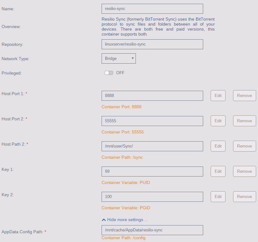

I'm on Unraid 6.5.0 and have the same issue - while the resillio sync container is running, disks won't spin down.
My config is as follows:
Can anyone help with the issue?

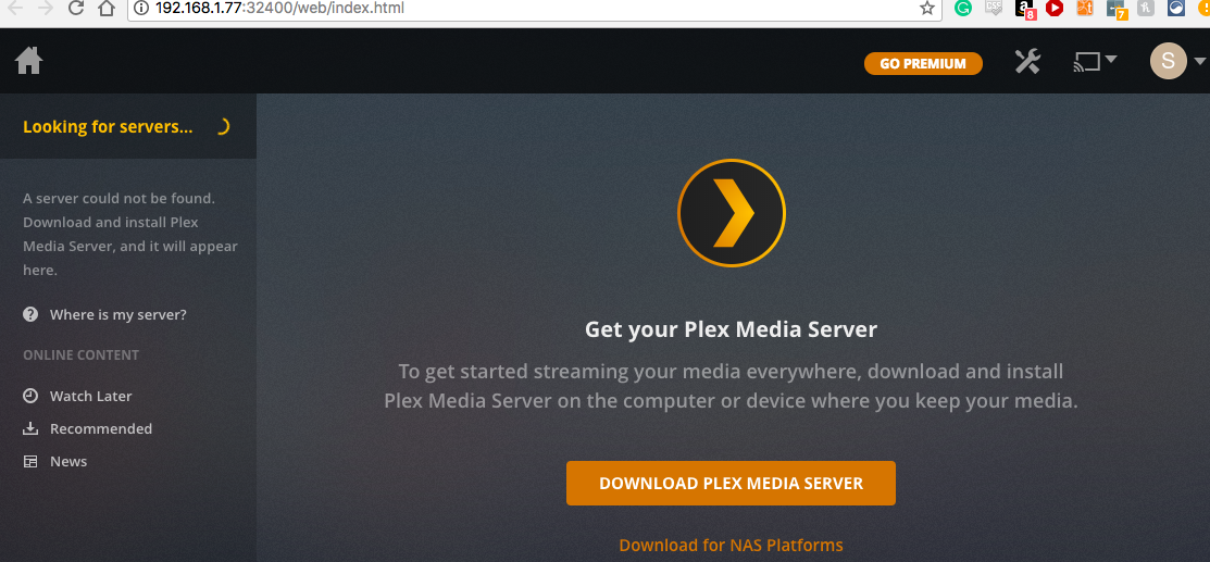

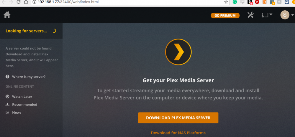

I am a newbie here. I installed Plex Media Server as a Docker container on unRAID 6.5.0 (Dell T30 Server) and everything installed with no issues.
But when I browse to Plex WebUI then all I get this GUI. What am I missing here?
I resolved my issue by following instructions from this link.
https://quickbox.io/knowledgebase/setting-up-an-ssh-tunnel-for-plex/
This needs to be done from your local computer.
  1. Open PuTTY, enter your server IP address in the hostname and SSH port. Or, if you already have your server session setup and saved, just load the existing session.
  2. Go to “Connection > SSH > Tunnels“.
  3. Fill in “Source port” as “8888 and “Destination” as localhost:32400.
  4. Press the “Add” button.
  5. Now navigate back to the session homepage and press the “Save” button and then “Open” to connect to your server.
    Open a web browser from your local computer and navigate to http://localhost:8888/web <– type this is your browser exactly.
You will see a notice such as this appear when you first go to your plex localhost link:
Follow the on-screen instructions to complete the setup and add your media library.
Now you can access your media libraries from all of your devices at http://YOUR_SERVER_IP:32400 .
