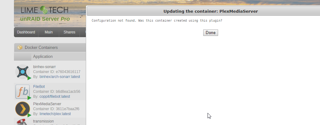

I am having updating issues too. When I try to update from the docker page I keep getting this popup. I am quite familiar with docker, but have never attempted to update software from inside a container.
The user template stored in config/plugins/dockerMan/templates-user is corrupted or you deleted them.  (Or the flash dropped offline)   only real recovery is to restore the file is you have a backup of the flash drive.   Barring that you will have to remove the container and then readd it
