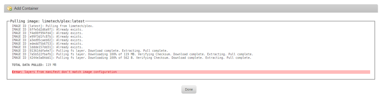

Hey all, been trying to update but have been getting this error: Error: "layers from manifest don't match image configuration"
What does this mean exactly? - Thanks
Means you need to read the Docker FAQ  ;)

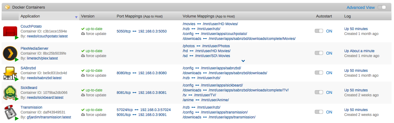

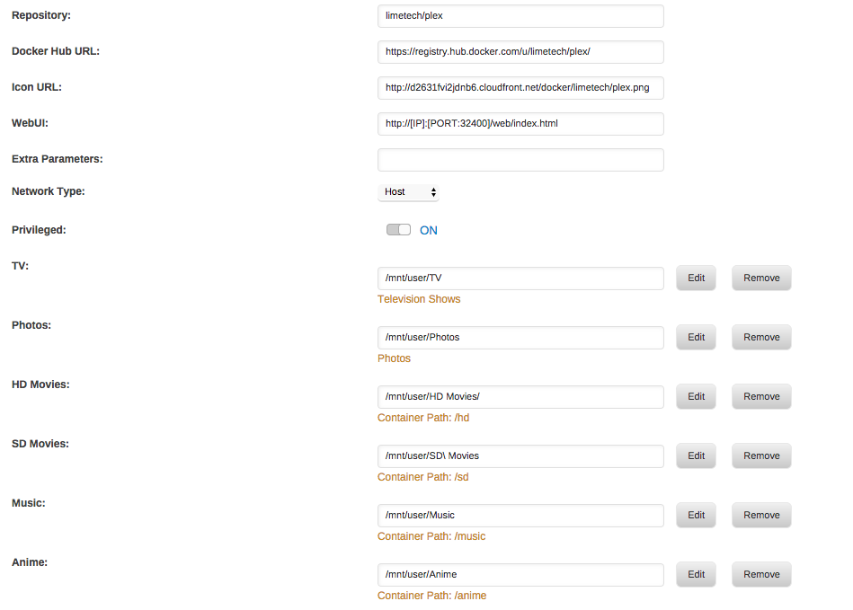

Hi Guys,
This is kicking my ass - I need help. For some reason, at some point recently Plex no longer maps a port, preventing access via the local webgui. I can access it just fine via plex.tv, can stream stuff etc, but all devices on the home network think it's a remote device.
I've tried creating a new config folder, I've tried deleting and re-downloading and configuring the docker from the limetech template, and literally everything works...but no WebGUI.
I've posted screenshots of the config pane, as well as the docker panel so you can see the GUI mapping missing. Any help would be greatly appreciated!

Running version 6.2.4 and am unable to reinstall PlexMediaServer via LimeTech Template... receiving "Error: Layers from manifest don't match image configuration". I'm a newbie so if you know the fix I'll need some extra guidance. Sure appreciate any help you guys can throw my way. I'm willing to pay, just need the help and soon. Thank you.
RESOLVED THROUGH SSH
Step 1 >
root@Cosmos:~# docker images
REPOSITORY                  TAG              IMAGE ID                CREATED                SIZE
<none>                          <none>        7d06a524826d        6 months ago        539 MB
docker/v1.10-migrator    latest            a6d1771cced2        11 months ago      9.368 MB
Step 2 >
root@PLEXSERVER:~# docker rmi 7d06a524826d
root@PLEXSERVER:~# docker rmi a6d1771cced2
Step 3>
Reinstalled docker/PlexServer

"layers from manifest" was discussed in the Release Notes for 6.2 and in quite a few threads by other users who didn't seem to find the information for some reason.
A search of the forum for that phrase has quite a lot of matches.
See How to Search sticky linked in my sig.
