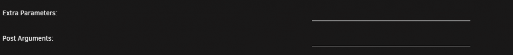

2 hours ago, Kurisu said:
"Post Arguments"
Via the Post Arguments field on the template
  • Replies 808
  • Views 444.8k
Could you point me out to the correct syntax ? I was only able to found <ExtraParams> </ExtraParams> that adds Extra Parameters, however i was not able to find the correct syntax for Post Arguments.
Use the GUI.  Manually editing xml is fraught with problems.

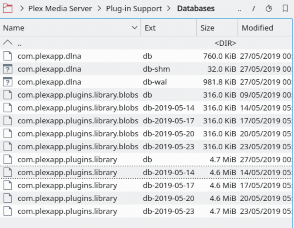

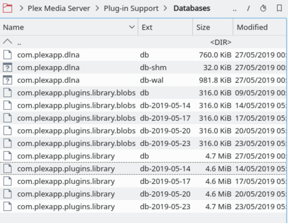

okay, thanks to Cessquill's advice for not deleting plex's appdata, and after reinstalling and rebuilding my entire library again — which i don't mind since it's less than 300 media — i realized plex did take few backups of the previous now-corrupted library, which i believe can be restored by renaming it's extension and deleting the corrupted one. (not tested, thought.)

ksman75, this might be of help to you. you can find the backups in '/config/Library/Application Support/Plex Media Server/Plug-in Support/Databases' w/ extension of the date. you might want to give it a try and see where this takes you, since i've already rebuild mine.
Thanks! But I already knew about the backups. Be sure to not delete your newest uncorrupted database. I you restore a corrupted database, you'll be sorry!
