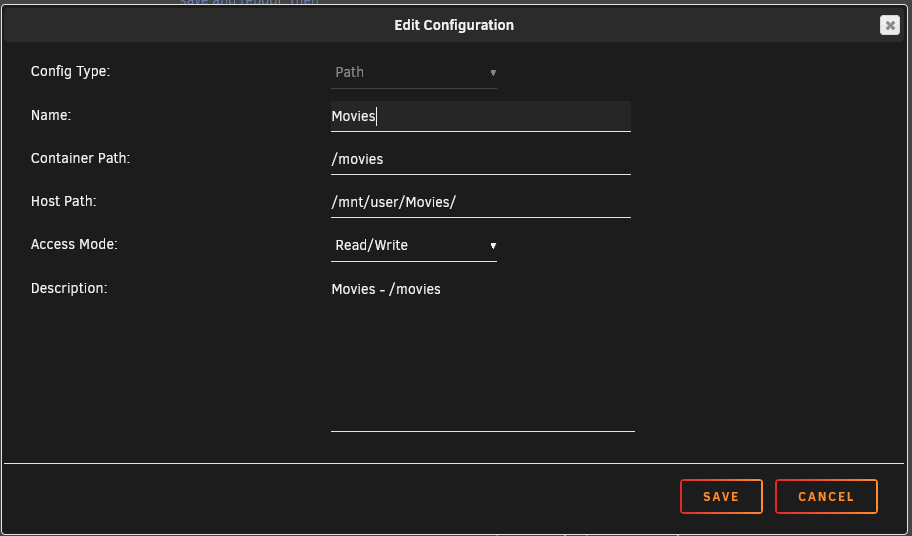

@Mike L
The Limetech Plex docker container is also no longer supported and they have encouraged users of the Limetech container to move to the linuxserver.io, Binhex or Plex Official docker container.
The first two are well-supported in these forums and the Plex Official container is supported through the Plex forums.
You need to learn about docker container volume mappings and map your host (unRAID) paths to container paths which will be the paths you specify in the Plex Media Server when adding folders to Plex libraries.
Here is a screenshot of my Movies mapping in the linuxserver.io Plex docker container as an example of what you need to do:
Thank you. I did this and it worked well.

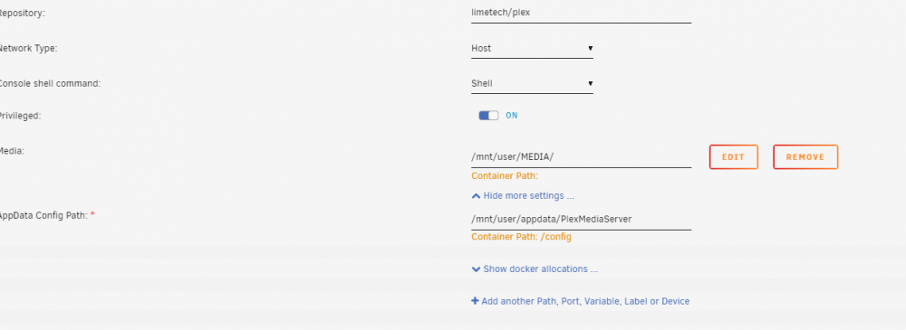

So I think there was an update to the Limetech docker earlier and now I my server is not showing up in plex at all. It says it can not find my server. I'm trying to understand what happened but no other changes were made. If I'm understanding others correctly, I need to move away from the Limetech docker?
I've downloaded the linuxserver docker but I really don't want to have to lose all the data from my Limetech docker such as album art, thumbnails, etc. It seems like there should be a way to transfer all that over to the linuxserver docker and as best I can tell I've set it up the same way as far as the paths for all my media but once I start the linuxserver docker it is asking me to set up all the paths to my media and there is no album art or anything on the items it's imported.
I've spent the last week letting my plex docker generate thumbnails on hundreds of movies and tv shows and can not stand the thought of having to do all that again if the Limetech docker is no longer supported. If someone would be willing to help me understand what I need to do to get this plex server up and running again I would be extremely grateful. If any additional information is needed I'd be glad to provide it.

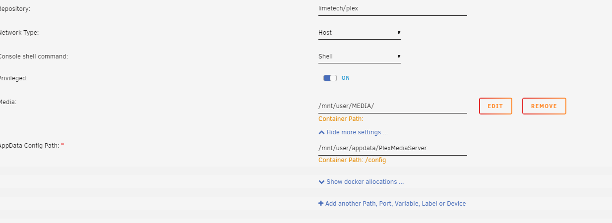

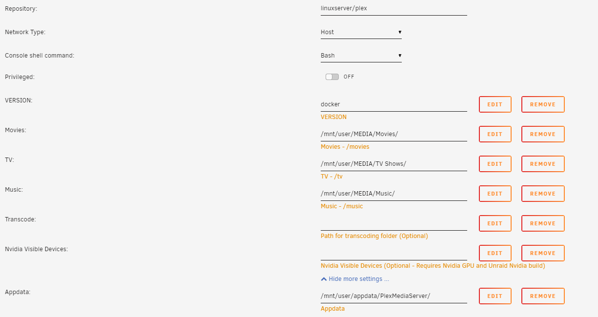

I'm not entirely sure how to interpret your "current" and "new", but they definitely don't look like you have set them up the same. Did you take a backup of the appdata before trying to switch?
To be honest I really don't understand docker that well or the file structure for Unraid that well either so please forgive my lack of ability to communicate what I'm trying to say.
I'm struggling to understand where plex stores the database of watched movies, the artwork, etc.
May I ask what you mean by they don't look like they are set the up the same? Would it help if I post pictures of how they are configured?

Have you already run the "new"? If so it may be too late to do the backup, since it looks like you told the "new" to use the same appdata path as the "current"
Screenshot captures might help.
Attached are the pictures of each
Edited by BudgetAudiophile
Those screenshots show that you have several more mappings to your media in linuxserver, so it will be seeing these in separate root folders, whereas your limetech has a single media mapping, so it will be seeing a single root folder for your media.

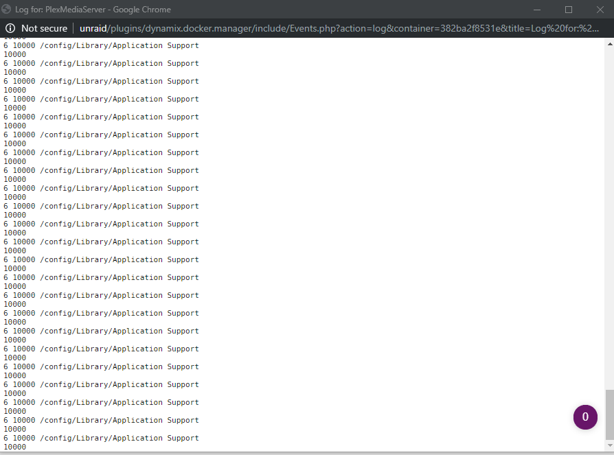

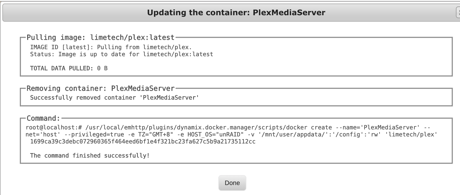

When I look at the log in the limetech docker this is what I see:
Furthermore, I show that the appdata folder still has like 22 GB worth of data in it. So i'm hoping that means nothing is overwritten. When I try to access the Plex UI I just get the server is unavailable message when running the limetech docker. Is it possible the database is corrupt and I need to revert to a backup version?
Ok, so it appears that perhaps my database got corrupted again. I did a restore and all is well.

Docker Run Command:
root@localhost:# /usr/local/emhttp/plugins/dynamix.docker.manager/scripts/docker run -d --name='PlexMediaServer' --net='host' --privileged=true -e TZ="America/Chicago" -e HOST_OS="Unraid" -v '/mnt/user/MEDIA/':'/MyMedia':'rw' -v '/mnt/user/appdata/PlexMediaServer':'/config':'rw' 'limetech/plex'
c1e128a2bf2c86c7e49caae305c7b014cbb43f1e91ad0ed7fe9b8661ca5da476
The command finished successfully!

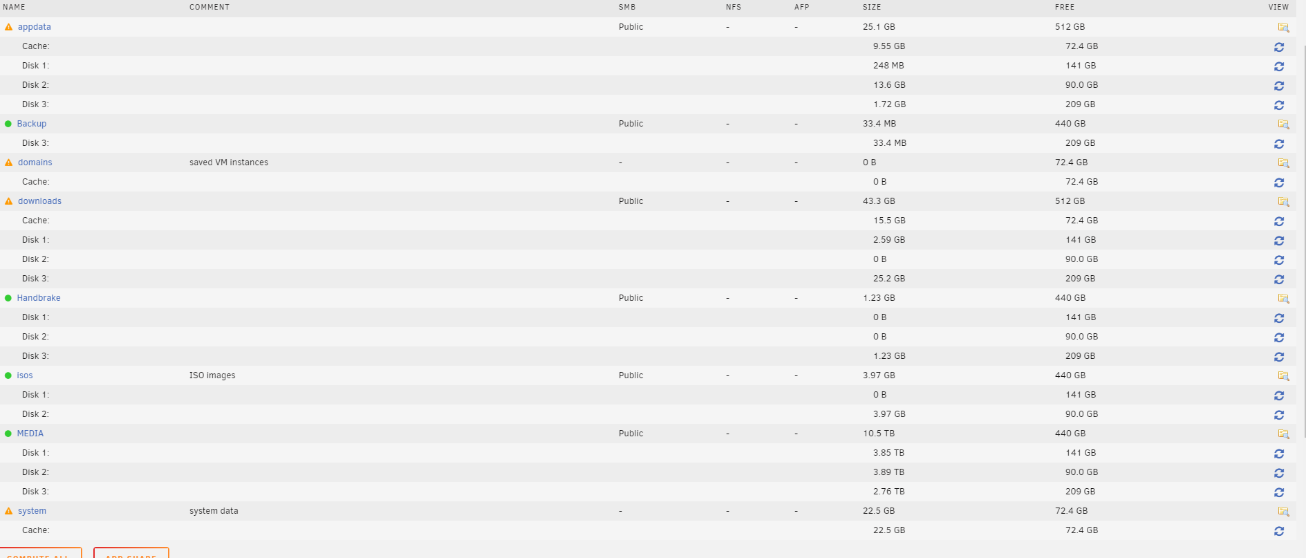

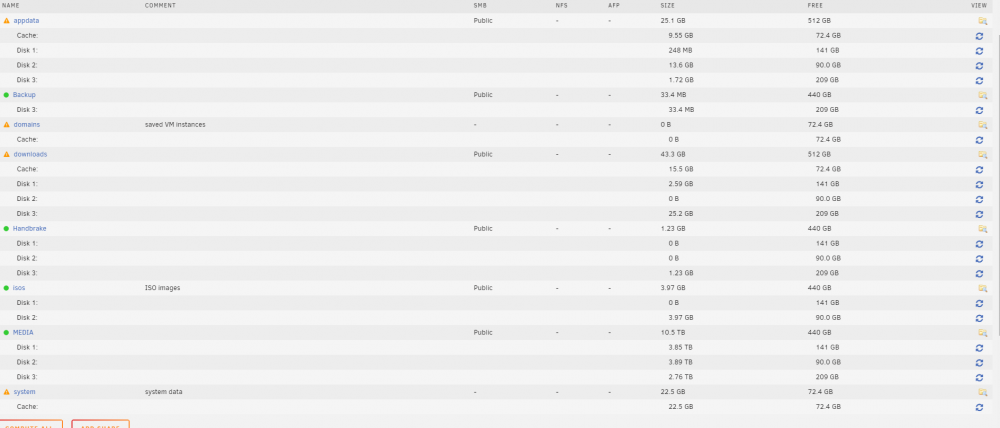

Your array disks are pretty full. You should probably plan to have more capacity.
Your appdata is set to cache-no. It has some data on cache and some on various array disks. This isn't the recommended configuration. You want your apps on cache so they will perform better, and so they won't keep parity and array disks spun up.
Your cache is pretty small though, so it might be best if you don't cache any of your other shares and just have your dockers on cache.
In order to get mover to move your appdata user share to cache, you will have to set it to cache-prefer. You will also have to temporarily disable the docker service (Settings - Docker) since mover won't move open files.
Before you run mover though, let's get a better idea how much of each user share is on each disk. Go to Shares - User Shares and click the Compute All button. It will take a while to produce the result. If it hasn't shown the result after several minutes refresh the page. Post a screenshot showing the results.
Yes, I do need to add more space. Been waiting for a good deal on an 8 or 10 TB Red drive but may have to give in soon and just get some smaller ones.
I also need to add another cache drive and a larger one at that. Here is the screenshot. computeshares.thumb.PNG.3cbb3e9a78172f7574fc567dc10f98a5.PNG
Looks like you should have enough capacity on array and cache to move things where they belong.
You will have to stop the docker service so none of your dockers are running. Mover can't move open files. Then set your appdata to cache-prefer to get it moved from array to cache. Looks like total amount that would get moved from array to cache is less than 20G and you have a lot more than that free.
The downloads share would move only 15.5G from cache to array and you have more free space than that on the array, so that should be OK too. So:

You need to consider your Minimum Free for each of your user shares and for the cache drive.
When Unraid begins to write a file, it doesn't know how large the file will become. Once it has chosen a disk to write it won't change its mind or try to move it to another disk if it runs out of space. It will just fail. Minimum Free is how you get it to choose a different disk before it begins to write. Any disk that doesn't have more than Minimum Free on it will not be chosen. Each user share has a Minimum Free setting. It should be set to larger than the largest file you expect to write to the share.
Cache Minimum Free setting is in Global Share Settings and works similarly. Cache-yes shares will overflow to the array when cache has less than minimum, and cache-prefer shares won't get moved to cache if cache has less than minimum.
