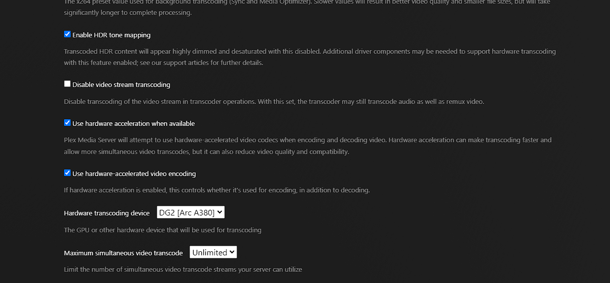

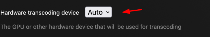

alturismo Posted Tuesday at 03:48 AM Share Posted Tuesday at 03:48 AM 1 hour ago, bobdole199534 said: I just removed all the ram transcoding stuff and it still doesn’t use my gpu. and its enabled in plex settings ? hardware transcoding settings gpu device available ... Quote Link to comment
bobdole199534 Posted Tuesday at 03:56 AM Share Posted Tuesday at 03:56 AM Yeah I've never seen anything show up here before. Also doesn't show up in plex, just shows auto. I'll redo the GPU installation and check back. Based on my limited knowlege I think I set up the container properly. Quote Link to comment
alturismo Posted Tuesday at 03:58 AM Share Posted Tuesday at 03:58 AM 1 minute ago, bobdole199534 said: Based on my limited knowlege I think I set up the container properly. can you see the NV device when clicking the dropdown on device ? Quote Link to comment
bobdole199534 Posted Tuesday at 04:56 AM Share Posted Tuesday at 04:56 AM 56 minutes ago, alturismo said: can you see the NV device when clicking the dropdown on device ? No it’s not listed there. Sorry I should have mentioned that. That makes me think there’s an issue with the GPU and docker all together. I’ll delete the drivers and the GPU plug in and start over. Quote Link to comment
alturismo Posted Tuesday at 05:04 AM Share Posted Tuesday at 05:04 AM 7 minutes ago, bobdole199534 said: That makes me think there’s an issue with the GPU and docker all together. I’ll delete the drivers and the GPU plug in and start over. i would say nvidia plugin and driver is looking ok Quote Link to comment
alturismo Posted Tuesday at 05:07 AM Share Posted Tuesday at 05:07 AM rather recheck GPU ID is not with a space in the end or something similar, and its an Variable im using the plexinc (official) docker, so cant say if there is currently some issues with Nvidia and lsio version ... but i guess no, as many are using this docker with nvidia too Quote Link to comment

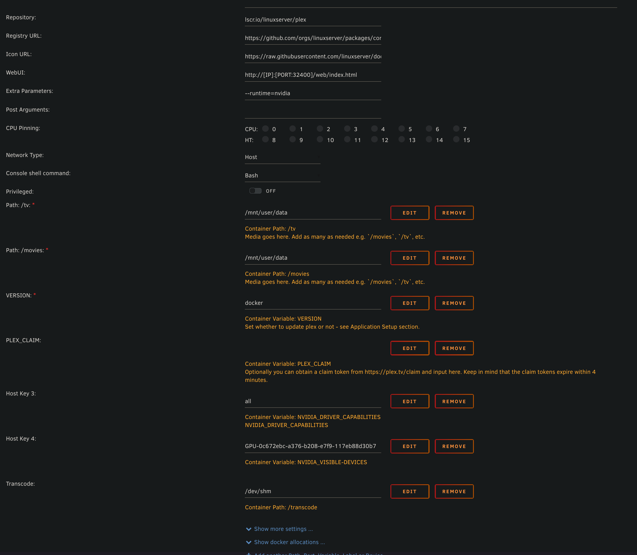

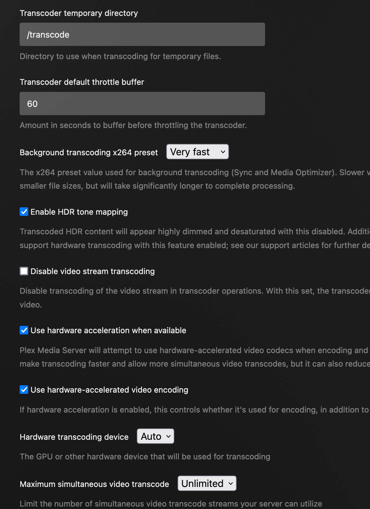

bobdole199534 Posted Tuesday at 03:54 PM Share Posted Tuesday at 03:54 PM 13 hours ago, bobdole199534 said: I'm having issues getting my hardware accelerated Transcoding to work with my nvidia GPU. Plex is using my CPU. This is what I have set up. I have the unraid drivers set up and plex pass. Is there any way to check if my GPU is passing through to docker all? I tried setting up headless steam for a while and I had a bunch of issues and I wasn't sure it was working with that either. I figured it out. I put NVIDIA_VISIBLE-DEVICES instead of NVIDIA_VISIBLE_DEVICES. Missing an underscore lol Quote Link to comment
