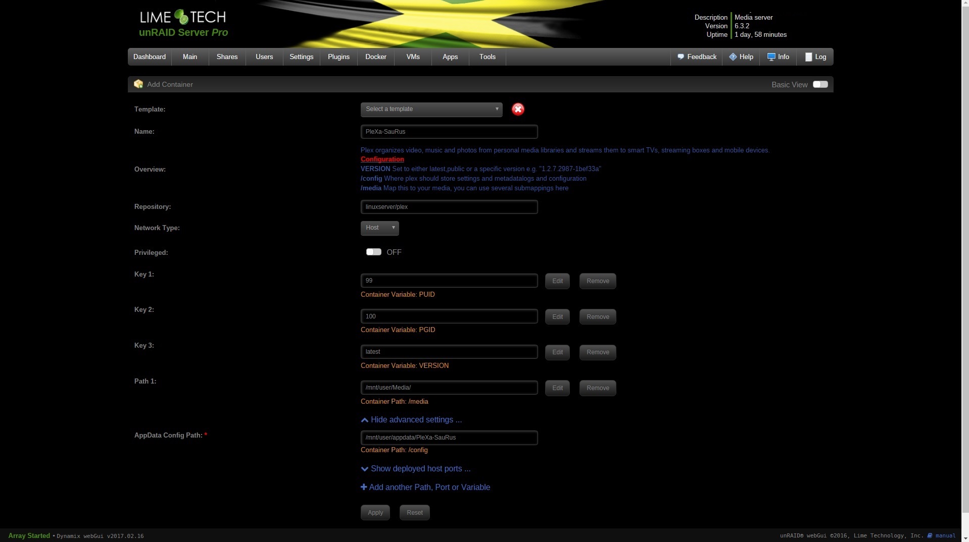

  • Yep, seems like the problem.   Not to be outdone... google.  And what do I find.... Hoopster's post from over a year ago. I see your post here regarding the iGPU not being enabled corr
17 minutes ago, CHBMB said:
That's the one but if VERSION="2.13.0" is not a valid parameter.  Look here, VERSION should be either latest, plexpass or a specific version number, and 2.13.0 I can tell by looking isn't a valid one.   Not that I think this is contributing to your current issue.
Well...that used to be just 'latest'; but I futzed with it, to try and solve the issue.
And the other questions?  No idea where you got 2.13.0 from, PMS is only on version 1.43 I think. O.o
Obviously, I was looking at the version of the wrong thing. But 'latest' works, right; and that's what it was...when the issue just cropped up.

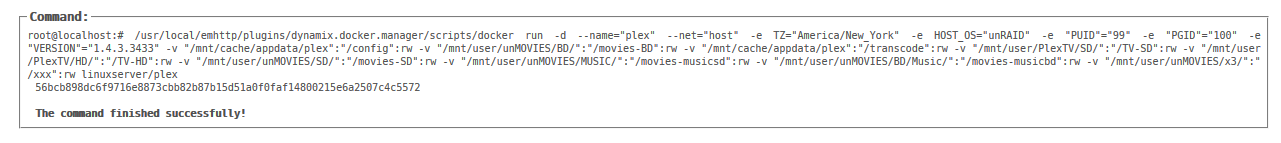

Applied...
And here's the subsequent run command...

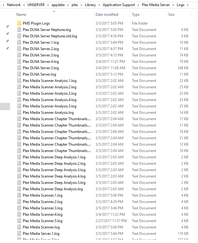

I don't see how I can help you any further I've given you the directory they are in and the file is named Plex Media Server.log
25 minutes ago, CHBMB said:
@CDLehner
By Plex logs I mean the ones in your /mnt/cache/appdata/plex/Library/Application Support/Plex Media Server/Logs/
3 minutes ago, CDLehner said:
OK; I'll change Moonlight. Can you help me, with the "right" logs?
Thx
He already supplied you the info twice where the log is.

OK; which log(s) do you want?
My guess would be trigger a library update and then look at Plex Media Scanner.log

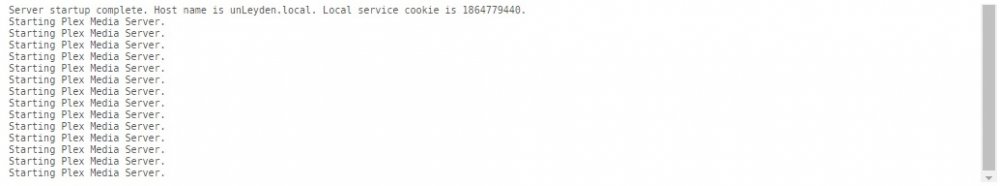

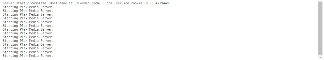

I had the linuxserver.io version of plex running very smooth for a little over 2wks. I can truly appreciate the snappy navigation of plex in a docker & ease of linuxserver.io's update process...it worked wonderfully!!! However, the docker is no longer launching; my streaming devices cannot find the server & I keep getting "This site can't be reached" (chrome & IE) when attempting to access the plex WebUI. I've tried an un&re-install of the docker, but no change. The plex docker log is continuously displaying "Starting Plex Media Server."...partial log attached. I even tried the binhex & limetech docker versions as well...still no love.
I can only think of one thing that I've recently done that could be affecting the docker from launching. Which was my "attempt" to setup a rsync session with another local storage server; without having to input a ssh password each time & also binding transfers over a 10GbE direct connection.
I digress, I'm not at all good with linux so I followed along with a youtube tutorial. One of the commands was **chmod600/root/.ssh/authorized_keys**. I didn't know at the time but as you linux vets may very well know, the chmod command pertains to the access permissions (read/write in this case).
A member from another forum mentioned having to modify his chmod to get his linuxserver.io plex version working. It got me thinking that the key generation/transfer or chmod settings in the youtube tutorial had something to do with derailing my unRAID plex experience :-(
I could very well be off base with this theory & nothing during the process is the culprit but any feedback/assistance would be GREATLY appreciated as I would love to be pleXing again through unRAID. In the meantime, I've been using plex through the other local server, but the unRAID hardware/docker makes the experience a lot snappier.
Another thing, the rsync setup didn't fully work as anticipated :-(
I was able to ssh in the other server (putty) & make some transfers but haven't been able to effectively bind the transfers to the 10GbE direct connection. This the least of my concerns at the moment though.

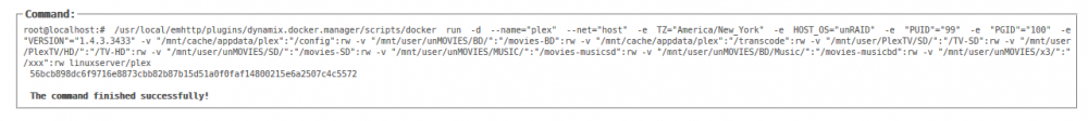

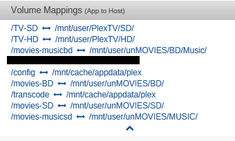

@CDLehner Plex is scanning /movies, and in your docker run command you've got movies in /movies-BD and movies in /movies-SD
You done some folder reconfiguration?
Edited by CHBMB
Bear with me here:
Again...nothing that wasn't working before; but...
/movie is my share...and I want Plex scanning all the movies in there. But I have "volumes", mapped for different libraries; like /movies-BD, /movies-SD, etc.
