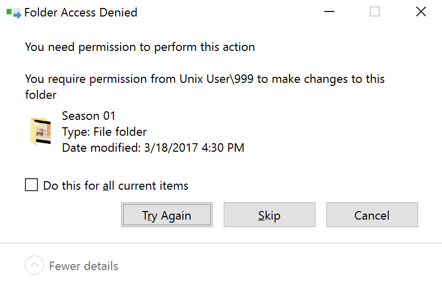

On 3/18/2017 at 5:06 PM, Endda said:
I just got Plex DVR setup on my unRAID box with this docker image and started testing recorded shows.
The thing is, I am unable to delete any recorded shows from a Windows explorer window. If I enable the delete feature within Plex, I can then delete recorded shows from within the Plex player, but i still can't delete them from the Windows explorer window
I'm being told that I require permission from Unix\999 to make changes to this folder/file (as shown in the attached image). Any idea what is going on here and how I could fix it?
This is preventing me to from running MCEBuddy from my desktop PC to cut out commercials from my unRAID PC (two different PCs).
You can run a script from the command prompt to reset the permissions. Unraid comes with one (at least it used to) called "newperms". You can specify a path, otherwise it processes every disk + cache resetting ownership and permissions.
I did a little edit (call it mynewperms) and store it on my flash disk that does not do the sync at the end (the sync spins up all of the disks).
So I type:
   /boot/mynewperms .
and it processes the current directory.
But you could run (for example):
   /boot/mynewperms /mnt/user/tvshows
You may already be doing something similar, but if not, this will at least keep you going until you get a more permanent solution.

It is usually advised to use the "Docker Safe New Perms" that gets installed in the "Tools" tab on unRAID with the Fix Common Problems plugin. That one is safe to do when your appdata directory is on your cache drive and you want to either do ALL drives or you want to just do the cache drive.
