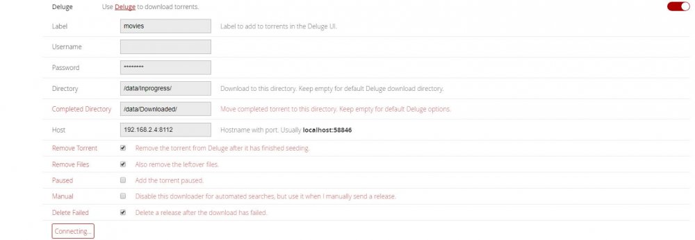

is there a trick to get CP to work with Binhex-deluge ? It will not connect! It will however use backhole but then i lose automation...  It doesnt connect and says check logs, which are empty...
I have tried:
localhost:8112
127.0.0.1:8112
192.168.2.4:8112
Edited by pyrater

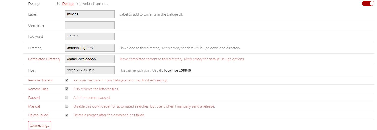

I have tried:
localhost:8112
127.0.0.1:8112
192.168.2.4:8112

sadly that didnt fix it.
Then either you didn't do it right or there's something different about your setup. Need to post some more info like docker run command for deluge and couchpotato

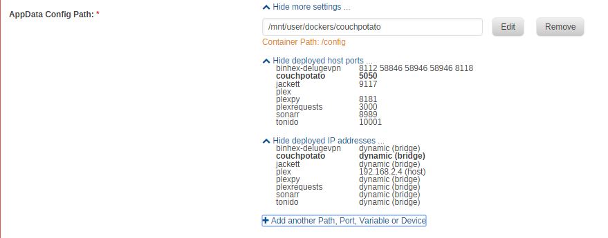

here are my mappings
Edited by pyrater
16 minutes ago, pyrater said:
I counted it (25 posts per page) and quoted above. its the post about disabling Privoxy. Which in my case didnt help.
It's nothing to do with disabling privoxy.  It's this post.
thank you CHBMB, this fixed it! you rock.
