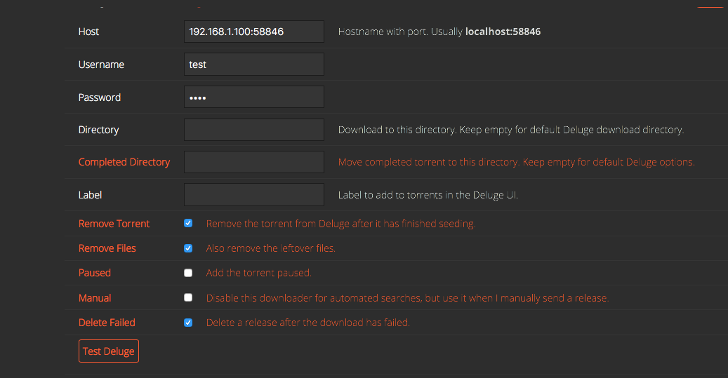

Hi.  I recently downloaded this.  I am also using linuxserver's Deluge.  linuxserver's sonarr connects to linuxserver's deluge properly.  but linuxserver's couchpotato cannot "see" deluge.
Deluge's network type is set to Host, is that right?  My Unraid's IP is 192.168.1.104, using port 8112.  Instead of using localhost:588xx, I'm using 192.168.1.104:8112 for my Deluge setting.  Username I used is admin, password, I have since changed to blank.  I've also added label to couchpotato movies.  Same goes in Deluge.  Any ideas?

make a user for deluge as per the
Add User to the authentication file
section here https://dev.deluge-torrent.org/wiki/UserGuide/ThinClient#AddUsertotheauthenticationfile the file being in /config/auth

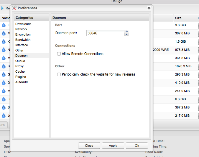

set remote connections on in deluge via the webui then restart the deluge docker (screenie shows it off which is wrong, lol)
then in couch use 58846 and the credentials to match the deluge user

Sorry, I'm lost with @sparklyballsinstructions as to how to add a deluge user, with the deluge app being in a docker container.  Kindly point out.  I'd also like to let you know that deluge with Sonarr is working fine, and can communicate, and send torrents to deluge properly.  CP can't see deluge.
@CHBMB, sorry I totally didn't understand what you're pointing out with the link above.
Look in your appdata deluge folder. Is the auth file not right there? I think you are way over-complicating things.
Did you click on the bit in the red box.  Step by step instructions to do what you want.
@jonathanm, thanks, I indeed overthinked it :D
@CHBMB, sorry, I didn't.  Instead, I clicked on 1329764278_ScreenShot2018-06-20at08_03_25.png.c857d9a870e11c18b31b5f75c1223e5a.png ? . Your instructions did the trick.
