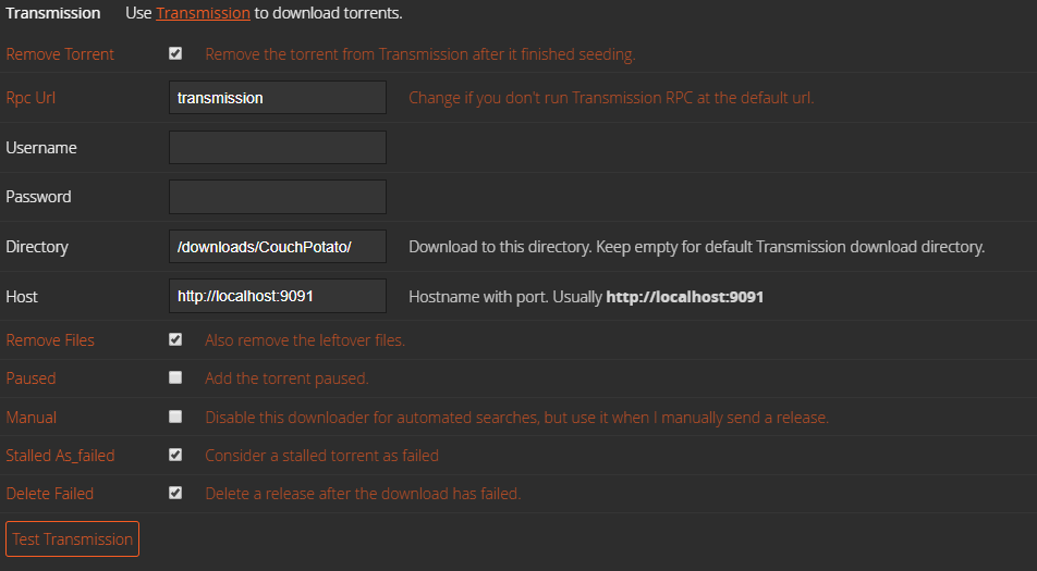

I think I'm going to loose my mind over something so so so simple.
No matter what I do CouchPotato will NOT let me chance my transmission host IP to "192.168.1.200:9091"
The local IP of my unRaid server is "192.168.1.200" but localhost:9091 fails when tested. Changing it to "192.168.1.200:9091" and testing works just fine, but if I refresh the page or go to a different settings section is just reverts back to local host!
Someone please point out whatever it is I'm overlooking before I go insane. Thanks!
Wild guess, but what happens if you tab to a different field after you make the change? Not click with the mouse, hit the tab key.
No effect. Same issue.
Today I tried editing the config.ini via the unraid terminal.
Stopped the docker image.
Opened terminal.
cd /mnt/user/appdata/couchpotato
nano config.ini
Scrolled down and changed the host line to:
"host = http://192.168.1.200:9091"
Saved and closed the terminal.
Started the docker image and took a look at the settings, and wouldn't you know it reverted back to localhost.
I then said screw it and tried to edit the config file with the docker still running. No effect. Instantly reverts to localhost.
Redoing the CouchPotato wizard and switching to a different docker has no effect.
Editing the config file via CA Config Editor has no effect.
Changing download clients has no effect. The issue is seems to be limited to the CouchPotato docker. Something is simply overwriting changes to the host IP.
Welp. Going into the docker settings and changing the network type to HOST fixed the issue.
Setting the IP manually still reverts back to localhost, but now that works just fine.
It's always something stupid...
