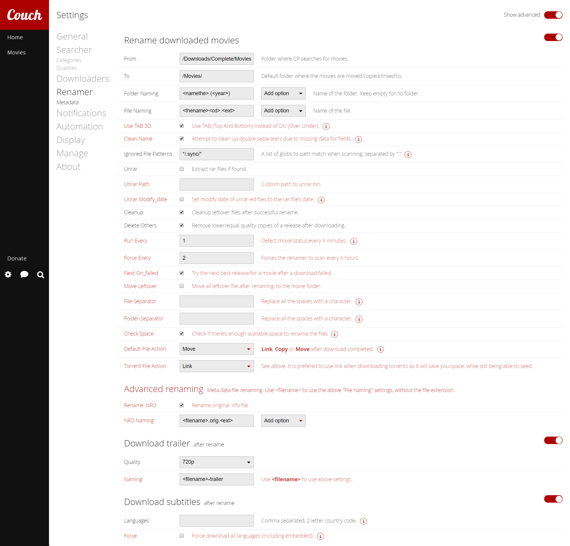

Sorry for the delay in answering.  So you need to setup your Renamer section so that couchpotato knows where to look for the movies and what to do with them.  Here is how I have it setup.
Its OK.. But now couchpotato picks up radarr downloads aswell.. How can I seperate them?
So you have your radar downloads in the same folder as your movie downloads?  I have a Movies subdirectory and a TV Shows subdirectory in my Completes directory.  This way you can direct couchpotato to look in \Completes\Movies and radarr to look in \Completes\TV Shows.

On 9/19/2019 at 1:54 PM, pcgirl said:
I use Sabnzbd.  And I believe that it dumps it into my Completed folder and then Sonarr and Couchpotato look in there.
Got it working by using DestDir in NZBGet - thanks for poiting me in the right direction :)
