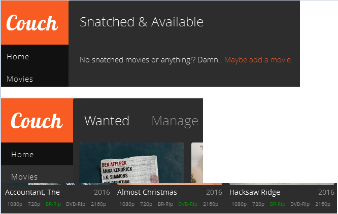

After the latest update, my home/wanted/movies screens are all blank.  Can still access settings and logs though.
11-29 12:25:04 ERROR
[ couchpotato.core.event] Error in event "profile.all", that wasn't caught: Traceback (most recent call last): File "/app/couchpotato/couchpotato/core/event.py", line 15, in runHandler return handler(*args, **kwargs) File "/app/couchpotato/couchpotato/core/plugins/profile/main.py", line 77, in all return [x['doc'] for x in profiles] File "/app/couchpotato/libs/CodernityDB/database.py", line 1035, in all "Index `%s` doesn't exists" % index_name) IndexNotFoundException: Index `profile` doesn't exists encoding=UTF-8 debug=False args=['--config_file=/config/config.ini', '--data_dir=/config/data'] app_dir=/app/couchpotato data_dir=/config/data desktop=None options=Namespace(config_file='/config/config.ini', console_log=False, daemon=False, data_dir='/config/data', debug=False, pid_file='/config/data/couchpotato.pid', quiet=False)
[ couchpotato.core.event] Error in event "quality.all", that wasn't caught: Traceback (most recent call last): File "/app/couchpotato/couchpotato/core/event.py", line 15, in runHandler return handler(*args, **kwargs) File "/app/couchpotato/couchpotato/core/plugins/quality/main.py", line 103, in all quality_doc = db.get('quality', quality.get('identifier'), with_doc = True)['doc'] File "/app/couchpotato/libs/CodernityDB/database_super_thread_safe.py", line 43, in _inner res = f(*args, **kwargs) File "/app/couchpotato/libs/CodernityDB/database.py", line 938, in get "Index `%s` doesn't exists" % index_name) IndexNotFoundException: Index `quality` doesn't exists encoding=UTF-8 debug=False args=['--config_file=/config/config.ini', '--data_dir=/config/data'] app_dir=/app/couchpotato data_dir=/config/data desktop=None options=Namespace(config_file='/config/config.ini', console_log=False, daemon=False, data_dir='/config/data', debug=False, pid_file='/config/data/couchpotato.pid', quiet=False)
[ couchpotato.api] Failed doing api request "media.list": Traceback (most recent call last): File "/app/couchpotato/couchpotato/api.py", line 36, in run_handler res = api[route](**kwargs) File "/app/couchpotato/couchpotato/core/media/_base/media/main.py", line 321, in listView search = kwargs.get('search') File "/app/couchpotato/couchpotato/core/media/_base/media/main.py", line 231, in list all_media_ids = all_media_ids.union(set([x['_id'] for x in db.get_many('media_by_type', media_type)])) File "/app/couchpotato/libs/CodernityDB/database.py", line 991, in get_many "Index `%s` doesn't exists" % index_name) IndexNotFoundException: Index `media_by_type` doesn't exists
[chpotato.core.plugins.log] API log: {'file': u'http://HOST/couch/static/scripts/combined.plugins.min.js?1480442483', 'message': u"chrome 54: \nUncaught TypeError: Cannot read property 'length' of undefined", 'line': u'863', 'page': u'http://HOST/', '_request': <couchpotato.api.ApiHandler object at 0x2b23449fe250>}
[ couchpotato.api] Failed doing api request "notification.listener": Traceback (most recent call last): File "/app/couchpotato/couchpotato/api.py", line 36, in run_handler res = api[route](**kwargs) File "/app/couchpotato/couchpotato/core/notifications/core/main.py", line 276, in listener for n in notifications: File "/app/couchpotato/libs/CodernityDB/database.py", line 1035, in all "Index `%s` doesn't exists" % index_name) IndexNotFoundException: Index `notification` doesn't exists
11-29 12:25:21 ERROR
[chpotato.core.plugins.log] API log: {'file': u'http://HOST/couch/static/scripts/combined.plugins.min.js?1480442483', 'message': u"chrome 54: \nUncaught TypeError: Cannot read property 'length' of undefined", 'line': u'863', 'page': u'http://HOST/couch/home/', '_request': <couchpotato.api.ApiHandler object at 0x2b2344adb710>}
11-29 12:25:56 ERROR
[tato.core.plugins.renamer] Failed checking snatched: Traceback (most recent call last): File "/app/couchpotato/couchpotato/core/plugins/renamer.py", line 932, in checkSnatched rels = list(fireEvent('release.with_status', ['snatched', 'seeding', 'missing'], single = True)) File "/app/couchpotato/couchpotato/core/plugins/release/main.py", line 536, in withStatus for ms in db.get_many('release_status', s): File "/app/couchpotato/libs/CodernityDB/database.py", line 991, in get_many "Index `%s` doesn't exists" % index_name) IndexNotFoundException: Index `release_status` doesn't exists

Hey...is anyone else finding that CP is no longer displaying queued media on the "Snatched & Available" dashboard after the most recent update?  Funny thing is; when selecting the "Wanted" tab under the "Movies" section, I see the results from my Searchers, the results that should be on the dashboard.  See the attached screenshots if I'm not making sense.
EDIT:  Running v40577904 (11/15/2016)
Hello Forum :)
Nope, same version works ok here.
