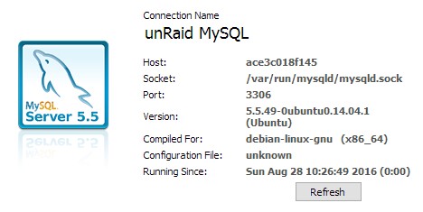

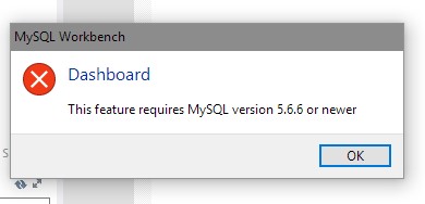

I've tried searching for this information on both google and the unraid forums but I could not find what I needed.  How can I update this version of MySQL.  According to the MySQL workbench I'm currently running 5.5.49-0ubunti0.14.04.1, is there any way to upgrade to 5.7.14?  When I click check for updates it claims it's up to date, is that because this isn't the official MySQL docker and therefore does not have the same update path? I deleted the entire docker once already and tried to install it as a new docker container, yet it still had the same version number, I thought I remembered an issue with unraid Pre 6.2 having issues with updating.  Currently im running UnRaid 6.2.0-rc2.  I have RC3 at home and have the exact same issue with this docker.  I guess I just don't know a whole lot about the whole docker on UnRaid yet.
If you have the same version on both servers the linuxio guys haven't updated the container. Since it reports Ubuntu 14.04 the latest version there is 5.5.50, so not a big upgrade anyway.
You just have to wait until they release a container based on a newer base image.
Gotcha. Like I said I don't know a whole lot about Unraid dockers vs regular docker. I'm in no rush, just some added management fetures in the newer version I was hoping to get access to. Thanks for the help.

As I answered in the post above you, 5.5.50 is the latest version on ubuntu 14.04. Until ubuntu updates the mysql package or we rebase it (don't know if/when that happens), I'm afraid you will not be able to use the feature.
