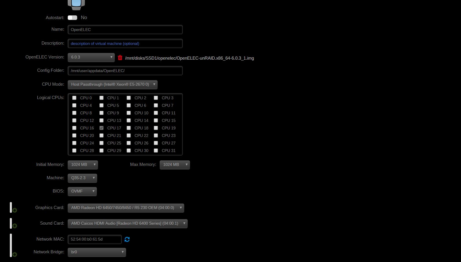

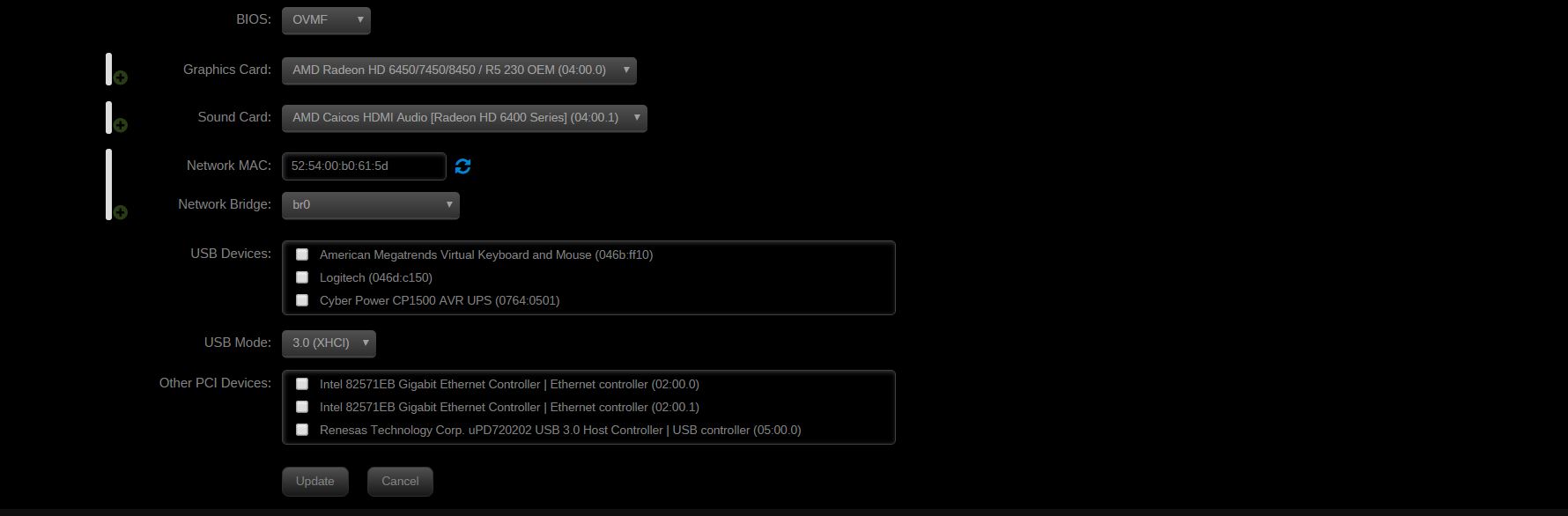

Updated to 6.2, attempted to install a fresh openelec VM using the unraid default.
I get a openelec/kodi boot screen, but it hard crashes. Searching the log in my openelec appdata folder I find this tidbit:
02:11:03 T:140213840799616  ERROR: GLX Error: No Display found
02:11:03 T:140213840799616  FATAL: CApplication::Create: Unable to init windowing system
System is with mostly defaults of the template, OVMF, Q35-2.5, 1GB RAM, AMD 6450 graphics card.
Diags attached, openelec log attached.
I am new to openelec and Kodi, google did not get me far in my search for this issue. Any help appreciated.
bigbang-diagnostics-20160915-2220.zip
kodi_crashlog_20160916021103.txt
Post screenshots of the kido vm config.
Pictures attached. Also to note, i tried the LibreElec template earlier tonight to no avail. Same issue with the no boot.
