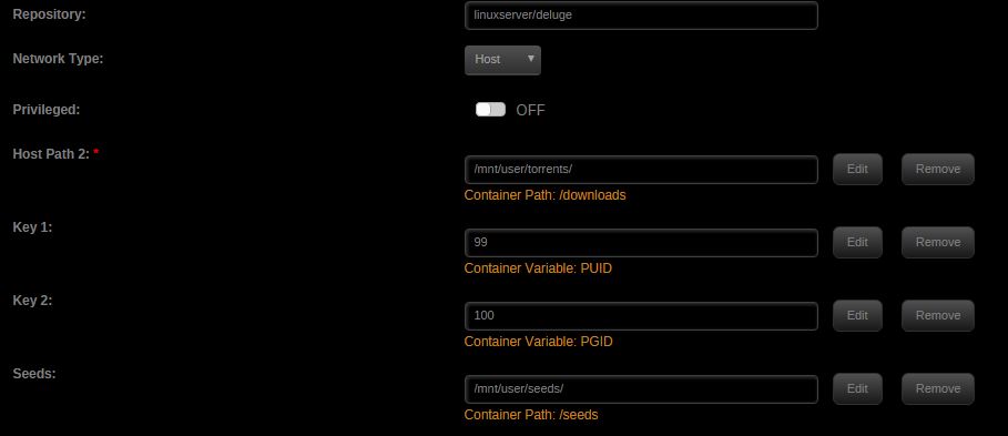

I'm trying to get this working, but the workflow stops halfway through.
I find an album I want, it is sent to Deluge and downloaded, but then Headphones doesn't see the file in the folder. It isn't an issue with the mapping I use the same file structure across all my automation apps and Deluge.
I'm guessing it is a issue with my setting within Headphones, but I haven't found where it is, and there really isn't a good setup guide for this software.
Any help is greatly appreciated.

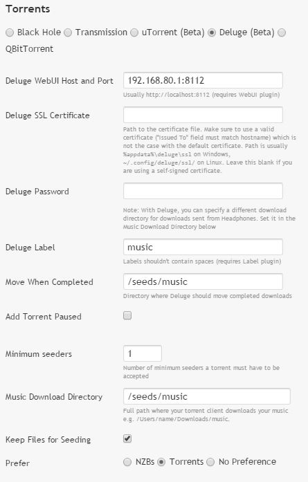

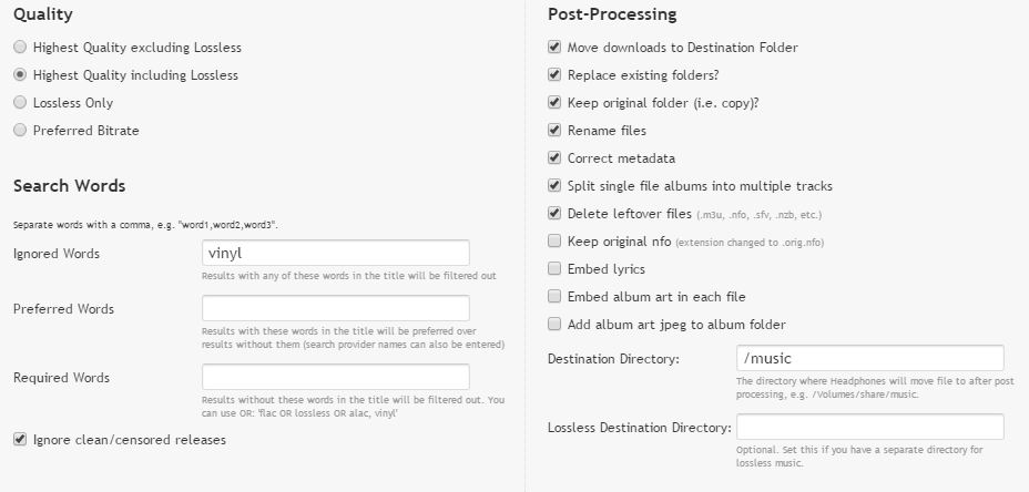

I don't use "downloads" like most I set it, Deluge is the only one to use it since the folder is on the cache. All files downloaded by deluge are moved to a "seeds" folder on the array once download is completed (/seeds/"label"). This setup is working fine for Sonarr and Radarr (and Couchpotato previously).
In the case of Headphones, it finds the file I want, sends to Deluge, Deluge does as asked (labels the file as music, and moves it to /seeds/music), and from there Headphones does nothing. I manually had HP import music files from a different folder I had put in /seeds, and it did its job with no issue.
I'm certain it is something that isn't configured correctly in HP settings, but no clue what it may be.

Should your "Music download directory" and " move when completed" directory be the same?

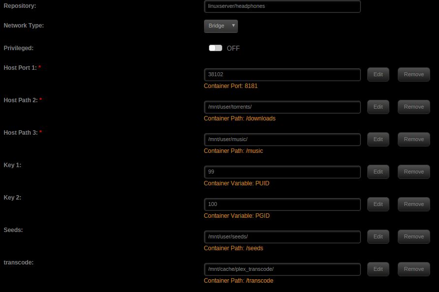

Can we see the the container path to the directories? The screen shots only show the host side. Well, they do show the container paths but that is technically just a description and may not actually be what the container path is.
I don't know, but when you read the info below where you fill in the paths it seems to indicate that it should be the same.
I'll try removing the "move when completed" information, and see if it helps (Deluge is already programmed to move the files).
***EDIT: Tried it. No change, no log errors.
I'm not sure what you mean. I would I go about getting that info?
If you would change anything, I'd think it's "music download directory". Deluge is already programmed to move files but Headphones has to know where those are.

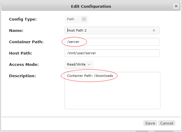

Click the 'edit' button next to the path in the docker config. The reason being, that orange text is just a description, not the actual path:
If you're lazy like me or just don't notice, you could change the container path and not change the description:2.png.6d23d802e9e650f1739b9b80877dcef2.png
In my case, the description says the container path is /downloads but it is actually /server. So, if you and everyone helping are operating under the assumption that the description and container path are the same when they are not, it could cause problems. They very well may be the same for you, I just don't want to assume.
Edited by bobbintb
I see what you mean. I double checked and my paths are correct.
Also, I manually add /seeds path.
Any other ideas?
