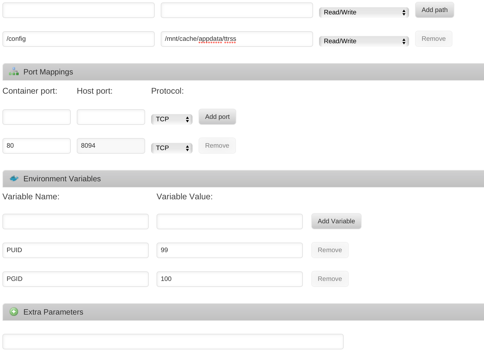

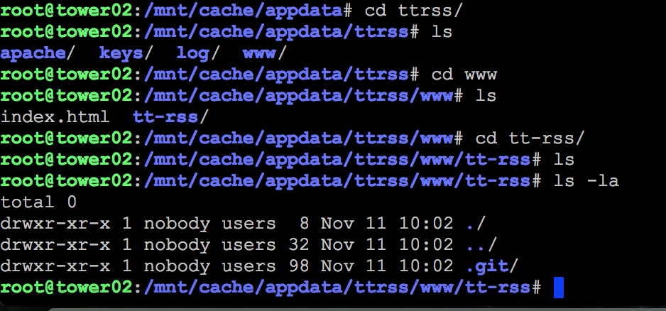

November 11, 201511 yr I tried out the tt-rss docker and was not able to get the web interface to come up. When I look on the filesystem the "www" directory only has .git in it and not the actual webui files. Can someone else try it? thanks!

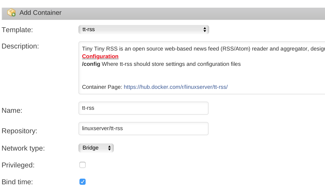

November 11, 201511 yr it's all good here. can you post a screen shot of your unraid template settings ?
November 11, 201511 yr the initial git pull can take a few minutes to get from tt-rss. if however you've stopped the container before it completed then the remnants of the failed pull will stop a new pull completing. the remedy is to stop the container, go to the appdata folder and delete www/tt-rss , the whole folder tt-rrs , not just its contents. restart the container and give a good few minutes, depending on your net speed for the pull to complete.
November 11, 201511 yr I guess I was being impatient. On the docker creation screen when it said it was done I assumed it was. I left it well alone and the files are there now. Thanks for your help.
November 11, 201511 yr I guess I was being impatient. On the docker creation screen when it said it was done I assumed it was. I left it well alone and the files are there now. Thanks for your help. Yeah.. because our dockers update on startup, the startup process can take a bit

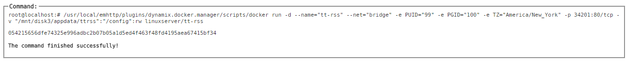

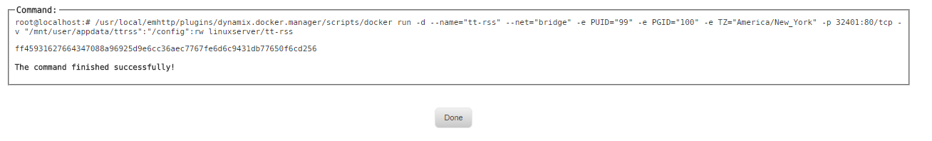

September 15, 201610 yr After installing this docker, my config directory is empty and docker never starts up. I have tried a few times to install it which is why there is multiple ttrss folders in the below screenshot.
September 15, 201610 yr Start Here http://lime-technology.com/forum/index.php?topic=40937.msg481150#msg481150
September 15, 201610 yr Start Here http://lime-technology.com/forum/index.php?topic=40937.msg481150#msg481150 Thank you squid. Attached is the command after install. I've also already tried the force update and to view the logs. Since it cannot start, there are no logs. ..... Just installed your Fix Common Problems plugin (http://lime-technology.com/forum/index.php?topic=48972.0), it said I was using a user share which are not good for Dockers. I didn't know this, I deleted the docker and reinstalled using disk3 instead of user and it worked. Is this standard practice? All of my other dockers work using user shared (i.e. nextcloud, plex, sync, syncthing)
