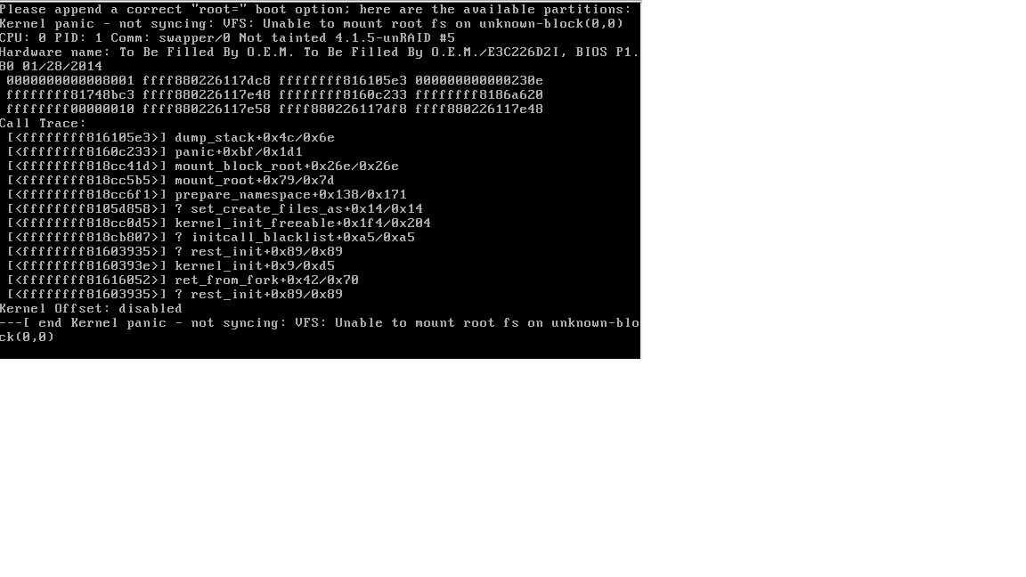

September 8, 201511 yr The update on my test server, which was running 6.1, worked but now my server won't boot anymore. It results in a kernel panic. See attached pic. Can anyone shine a light on this? Previous update from 6.0 to 6.1 went without a hitch on the same hardware. No changes were made.
September 8, 201511 yr If you can take the flash drive and do a check disk in a PC. I would the do a manual update and see if it works.. Looks like the file system can't be mounted. Might be a corrupt file. Hope this helps Thornwood

September 8, 201511 yr If you can take the flash drive and do a check disk in a PC. I would the do a manual update and see if it works.. Looks like the file system can't be mounted. Might be a corrupt file. Hope this helps Thornwood You were right. Check disk showed everything was ok, but after manual update the server booted. Updating through the GUI took longer than normal, perhaps that introduced a corrupted file.
