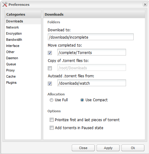

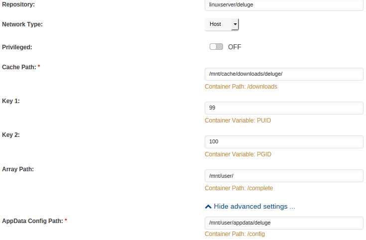

Please see my mappings in the screenshots below.
I want to use the cache=only share /downloads for watch and incomplete torrents, so my array is not spinning during the download.
When I add a new torrent, my default complete destination should be cache=yes /mnt/user/Torrents.
However I would also like to sort the downloads, If know where the download should go in the end.
Therefore I map /mnt/user as /complete into the Docker, so I am also able to select /complete/Media or /complete/Software or whatever directory on my cache=yes user shares.
How will Unraid behave, when deluge completes a download and start transferring from cache=only /downloads/incomplete to cache=yes /complete/Media?
Will the files just get renamed (path change) and stay on the cache pool until mover script starts?
Or will they be copied to cache=yes /complete/Media and deleted from cache=only /downloads/incomplete?
If the later, this would generate unneeded operation on the cache pool and double the wear of the SSD´s.
I hope you can give me some insight.

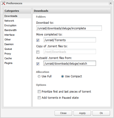

Let me translate it to my use case.
I would map the docker /unraid to /mnt/user.
I deluge I would set the following
Download to:          /unraid/downloads/deluge/incomplete (cache=only share)
Move completed to: /unraid/Torrents (or any other cache=yes share)
Autoadd:                  /unraid/downloads/deluge/watch (cache=only share)
From deluge perspective the operation after finished download is just rename.
Will unraid handle it the same way?

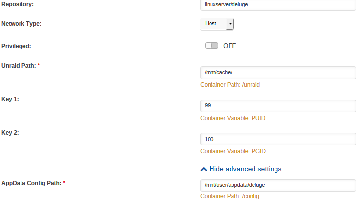

Oops  Sorry no...  My approach is correct, but implementation was wrong  8)
Its still traversing different mounts.  The only way to do this is to instead of /mnt/user use /mnt/cache
Mover will still operate on the file(s) within /mnt/user/Torrents, because it doesn't care how the file(s) got placed into that share.
Sidenote:  Personally, I don't think you really should be overly worried about trying to minimize writes to the drive as long as you have Dynamix Trim installed, and the drive isn't always insanely full.
Ok now I got it, /mnt/cache sounds reasonable.

Below if my final deluge config - see attachments.
Mapping explanation:
/unraid/downloads points to a cache only share.
/unraid/Torrents or /unraid/Media or /unraid/Software point to the cache storage of a regular array share (cache=yes required)
How should it work:
Deluge is watching and downloading to cache only share => Array Disks are not spinning
Deluge finished downloading => rename the file from /unraid/downloads/deluge/incomplete/movie.mp4 to /unraid/Torrent/movie.mp4 (as default download direction)
The file resides in the cache pool at /mnt/cache/Torrent/movie.mp4 until the Mover Script starts
The Mover Script move the file to the array => will be deleted from /mnt/cache/Torrent/movie.mp4
Users can access the file at /mnt/user/Torrent/movie.mp4 directly after deluge finished download
Upside:
Write only once to cache pool => no extra move operation on SSD
Mover can move it to array for long term storage
Possible to set downloads final destination on the array at "Add Torrents"
Downside:
Torrents moved to array have to be remapped, if longer seeding is required
Thanks Squid for guidance.
