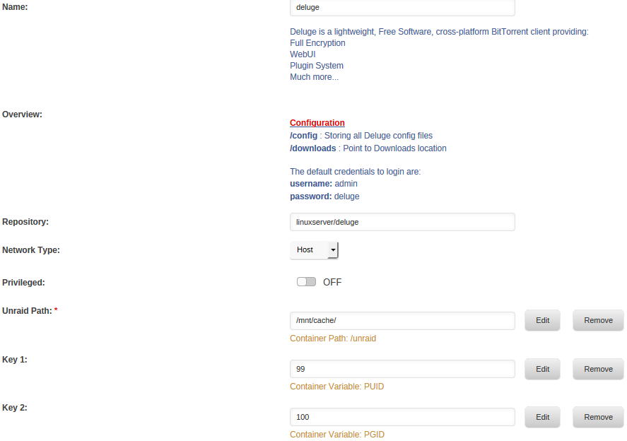

I have exactly the same issue.
Deluge is removing the write permission from user group on any folder it gets access.
So nobody can write/delete the files via SMB.
Haven´t changed anything inside the docker, see my config in attachment.

I use deluge for a couple of weeks now but now I get an ERR_EMPTY_RESPONSE when I trie to access the webui.
But the logs say the webui is running:
GID/UID
User uid: 99
User gid: 100

Does anyone know a solution because reinstalling didn't work
