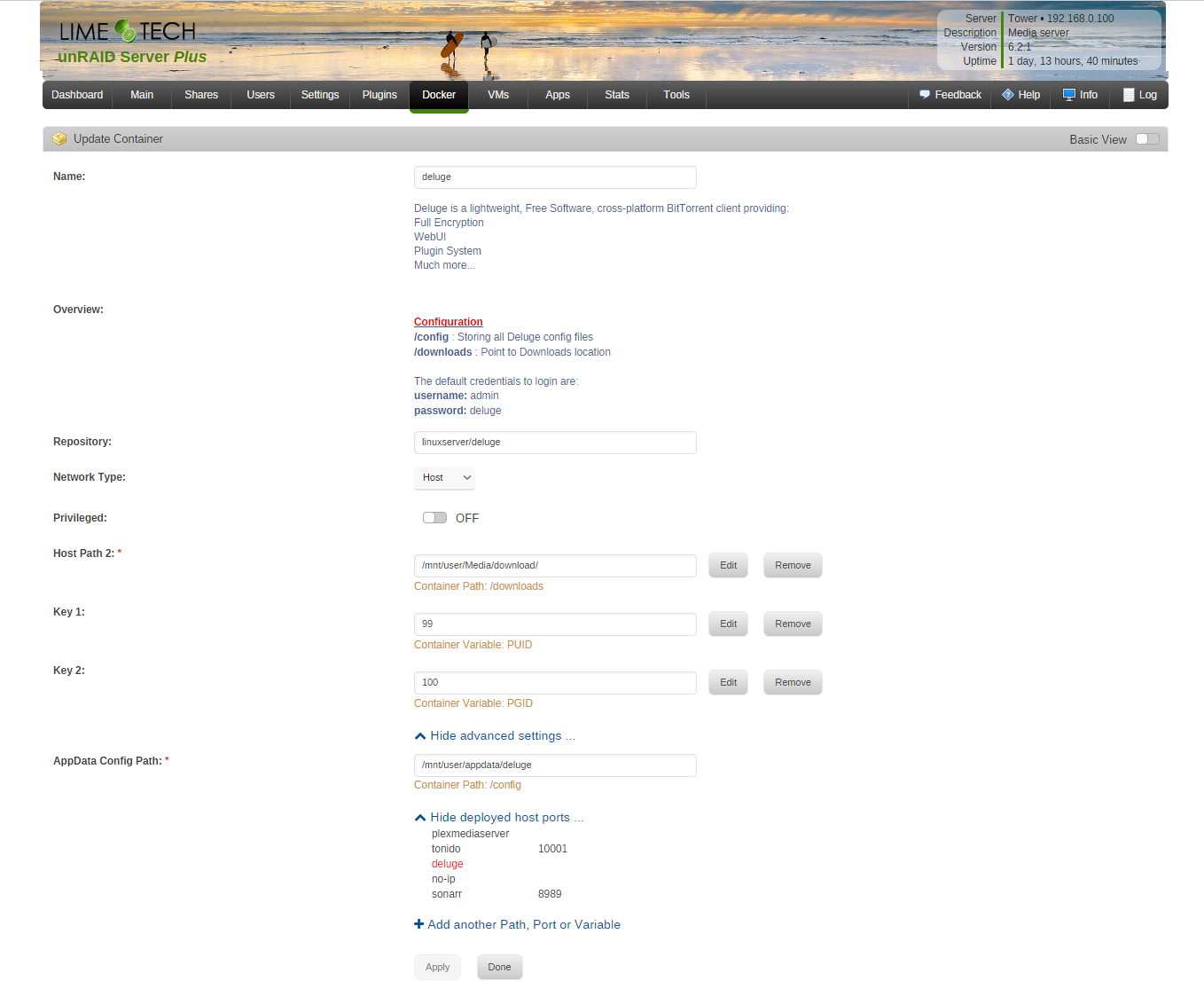

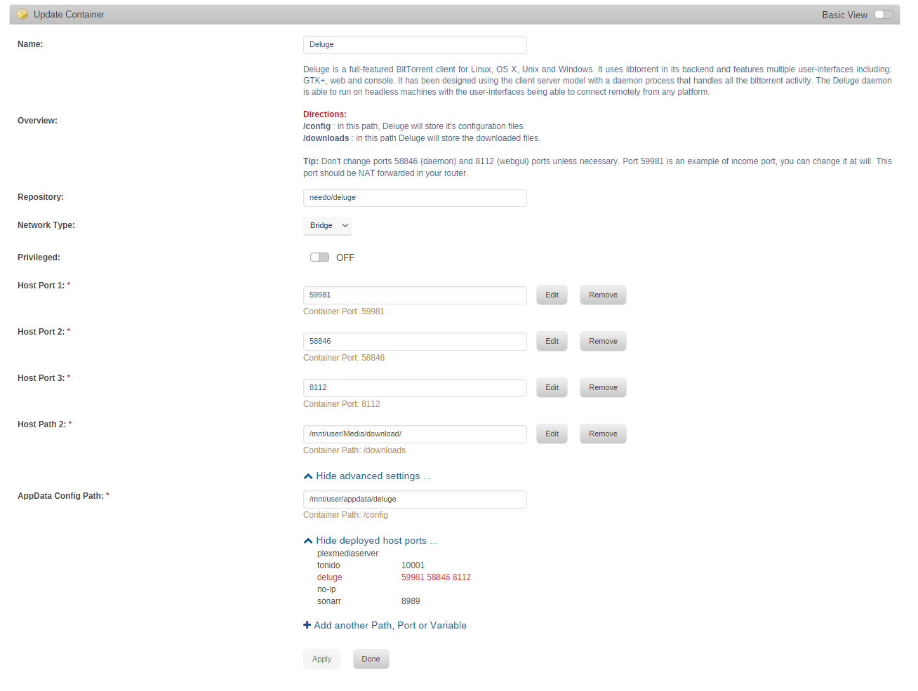

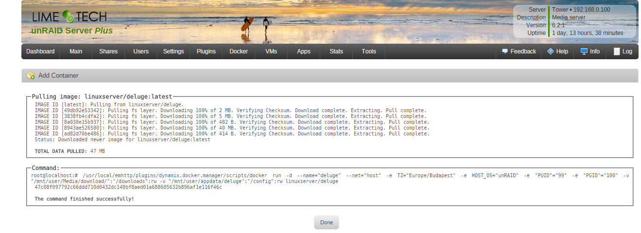

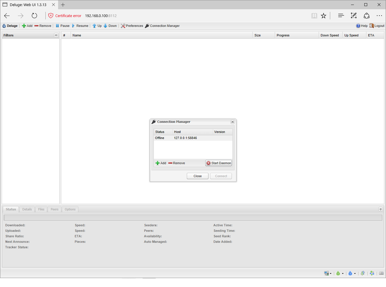

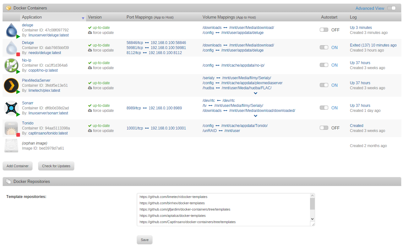

Thanks for the fast reply.
The actions i have performed are:
- stop Needo/Deluge server
- remove LinuxServer.io/Deluge (also remove image - checked in) through unRaid web interface.
- installed LinuxServer.io/Deluge
- configured the download directory to /mnt/user/Media/download/
- reused the existing deluge configuration in /mnt/user/appdata/deluge/
- unraid->Docker shows in web interface LinuxServer.io/Deluge being started
- Deluge web interface at https://192.168.0.100:8112 can't connect to the server. status = Offline
screenshots are attached and numbered chronologically (1-4)
attaching more screenshots
screenshots continuing.

The problems seems to be unRaid+Mover+Docker+Deluge 3.1.13 specific.
I am quite not sure if anyone in Deluge support would know what an unRaid mover is and how it works with the Deluge.
as the deluge complained about 2 docker containers using the same configuration directory, i removedthe needo/deluge docker (including image).
the resulting deluge.log file is short:
[iNFO    ] 16:54:48 configmanager:70 Setting config directory to: /config
[iNFO    ] 16:54:48 daemon:124 Deluge daemon 1.3.13
[iNFO    ] 16:54:48 core:85 Starting libtorrent 1.0.9.0 session..
[iNFO    ] 16:54:48 rpcserver:367 Starting DelugeRPC server :58846
[WARNING ] 16:54:48 preferencesmanager:496 Unable to find GeoIP database file!
[iNFO    ] 16:54:48 core:97 *** Start Label plugin ***
[iNFO    ] 16:54:48 pluginmanagerbase:158 Plugin Label enabled..
[iNFO    ] 16:54:48 pluginmanagerbase:158 Plugin Blocklist enabled..
[iNFO    ] 16:54:48 torrentmanager:650 Successfully loaded state file: /config/state/torrents.state
[iNFO    ] 16:54:48 torrentmanager:779 Successfully loaded fastresume file: /config/state/torrents.fastresume
I am using a https connection to the Deluge server (selfsigned certificate).
Deleting the content of /mnt/cache/appdata/deluge/state/ directory solves the Deluge server connection problem.
But it deletes all my torrent progress etc.
