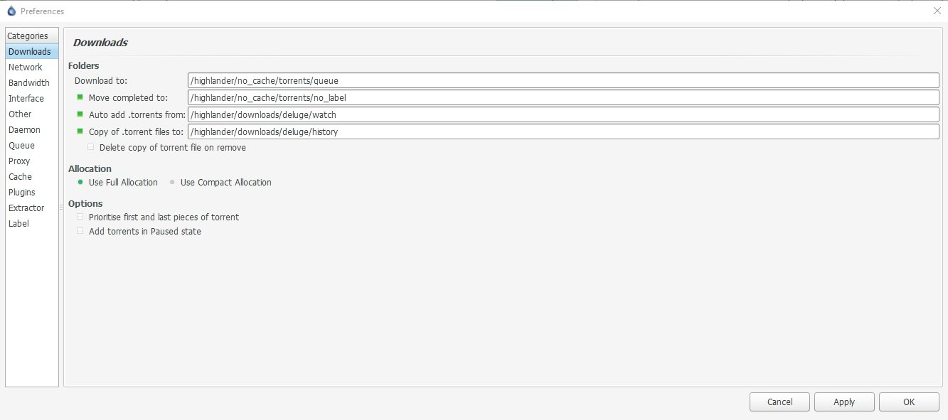

I'm hoping someone has a fix for this.  Whenever I restart the docker, several of my torrents will have Errors requiring rechecking. It's very annoying as it can take a day or two if it's a very large torrent.
Does anyone else have this problem?
Here are my mappings - appdata is set to R/W Slave on an UD.   Thanks in advance for any help
1114109374_FireShotCapture133-Highlander_UpdateContainer_-https___1d087a25aac48109ee9a15217a.thumb.png.368298e22dd121f450b9e20fa25ff687.png
What happens if you stop it from the command line doing this:
docker stop -t 60 deluge
Will it still have to check the consistency of the torrents?
Sent via Tapatalk because my wife thinks I spend too much time on the computer
Thanks - I'll have to try this maybe tomorrow/Monday. I've just created a fresh docker instance just in case some weird plugin settings etc were causing problems, so I'm re-adding my old torrents by rechecking.
