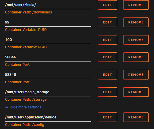

post screenshots of your volume mountings from the unraid webui and the Downloads section of the webui preferences for deluge itself.

i've been using this deluge docker for years now with the same mountings.
If I download something to the docker.img, than it would show in 2 seconds. I usually download 5-10-100gig torrents.
I checked the log size with a 'user script', which i found on this forum on a similiar topic. written by Squid I guess. it showed 500mb log after a 3 days uptime. i forced updated the image (auto update is off for deluge for me), than 1 min later, the script said my log is a few kb only.
since i updated deluge (few weeks ago), i regularly see higher than normal cpu usage on deluge, deluge-web as well. (and i guess it's normal, that if I update deluge docker, my webui password resets, right)
I think I didn't change any settings about logs, but the 6 month old build didn't have this issue.
If I get home, I will send you the mountings, but they are fine.

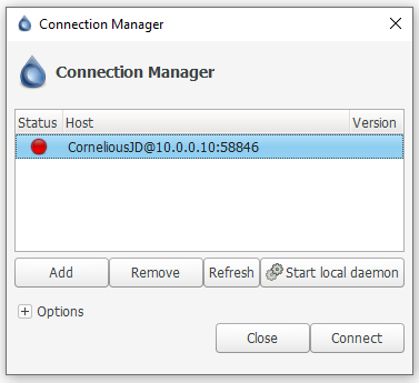

I'm having the issue where the Daemon keeps disconnecting over and over. Tried adding :145 to the repository path but it continues to disconnect. What can I do?
With this latest update (2.0.0 it seems) I can no longer connect with the daemon from Deluge installed on a Windows machine. Deluge 1.3.15 is all that seems to really be available on Windows still at this time. The connection manager now shows the server as down all the time.
(This is from 1.3.15 on Windows)
(This is from WebUI on Unraid)
Any advice on how to get this back up and working would be appreciated.

1 minute ago, CHBMB said:
Thanks, I did this in the meantime, after I noticed none of my torrents were seeding, (client not on whitelist) and I tried pulling 146 but it failed to open the WebUI after that. I went back to 135 and now Deluge opens but none of my torrents are there - everything is cleared out.
Do you know of a way to fix that? I had many on very different paths and labels, etc.
Why did you use 146?  It's seven months old.
5b398f77-ls22 would be the last pre v2 release.
To fix your missing torrents I guess it would be restore from a backup.
Thanks, I put in linuxserver/deluge:5b398f77-ls22
I honestly picked 146 at first because I wasn't completely following which arch I should pick on the newer releases, didn't realize that 5b398f77-ls22  would have automatically picked the proper one for me. I see my mistake now. I was just looking to go back to the release numbers I had recognized the last time I had a small issue, (back then I went to 135) -- that's why I ended up trying to go back to 135 again this time, just familiarity.
I'm on 5b398f77-ls22 now though, restored from backup from last night before the update happened, all back up and good to go! All torrents back and appear to be where they should be now!
Appreciate the assist @CHBMB! :)
