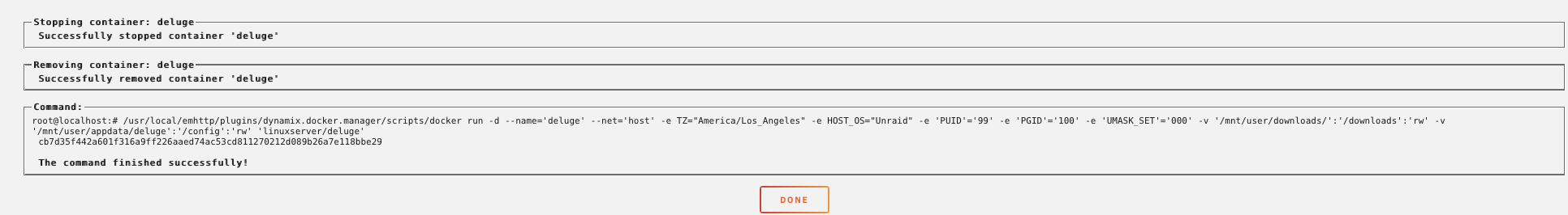

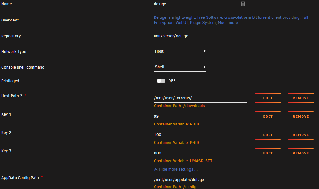

Post your docker run command and a screenshot of settings->downloads in deluge
Thanks for your time!
Here these are.
Hope this is what you meant about docker run command, took a screenshot of a console.
Sam
Not quite. Edit the docker, change something and change it back, then press apply. Then the docker run command will show
thanks for being patient
here it is
Everything looks good. I thought maybe it was a case of wrong volume mappings since what you described is a classic symptom of that, but as I said everything looks good. Dunno what causes your issue I'm afraid :/

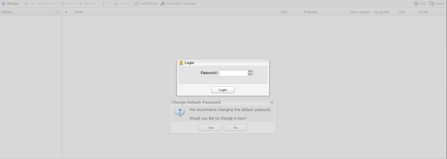

Just installed Deluge 2.0.3-2-201906121747 on Unraid 6.8.3 and I'm unable to log in. I'm getting stuck in an endless loop at the login prompt. The default password, "deluge", is accepted, but then the prompt reappears. In the background I can see a prompt asking me to change my password, but I can't select it.
I've tried to remove and install the plugin again, but I get the same result.
Ideas now I can get past this?
Thanks so much!

On 12/10/2020 at 8:38 AM, blakeslade said:
Morning!
Thanks so much!
When you "remove and reinstall" the plugin (docker container?), did you delete the "deluge" folder in /appdata?
If not, your config is still there and the new container install will see it and perpetuate the problem.
Rookie mistake. Thank you for pointing that out.
You are correct, I did not delete the "deluge" foler in /appdata.
Would explain why some other docker containers are also having some issues due to old configs remaining.
Will report back of the issue is not resolved.
Thank you!
