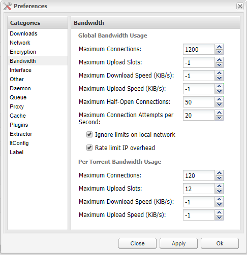

Quick poll - what do you guys have for your Bandwidth settings?I haven't touched the default half-open connections or the max connections attempts per second on my 200/200 line, and I wonder if I should. I use two private trackers IPT and Torrentday
1355070246_FireShotCapture53-D_12.0MU_303.4K-Deluge_WebUI1.3._-https___the-shepherds.com_deluge.png.65b91b1e8b16217f8f627590b5178459.png
