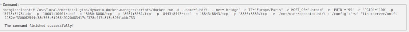

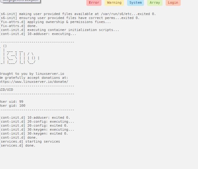

Hey guys I’m new to UnRAID and I just installed this UniFi controller docker on my unraid.
it starts but I cannot get into setup wizard.
Tried reinstall, change from bridge to host, change port, delete appdata  and still no luck
any ideas?
I was using the same docker on my raspberry pi and all works okay
Installed this one but when i click WebUI i get an error: This site is unreachable
Port 8443
Its not used by another one
Network type is bridge (should it be host?) Also whats the difference between the two anyway?
When i do set the docker as host and when as bridge?
I used the controller on my laptop till now, but now i want it on unraid
Can i use my settings from laptop or do i have to start over?
Once on unraid, can i switch back at laptop anytime or do i have to chose?
any ideas?
i got the same problem
I run mine in host so there is no problem.
Sent from my iPhone using Tapatalk Pro

run command, i click webui
then it goes to https://192.168.99.117:8443/
Log attached
Log attached
Need the docker run command.  Links to get it from my signature, you may need to switch on sigs in the forum settings to see it.
its fixed !
lol
I deleted everything
App was gone but there was still something on cache, deleted that too and reinstalled now it works
anyway
the run command attached
