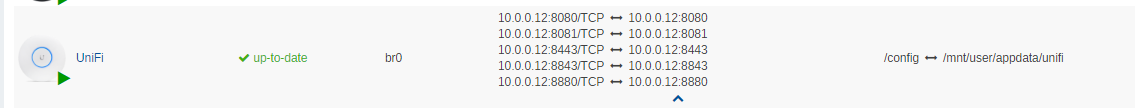

I'd really like to get this working without having it in host or br0 mode. Could someone let me know what I'm missing?
If I don't have it in br0 with it's own IP address everythign goes into a endless re-adoption cycle all the time.
Thanks in advance!

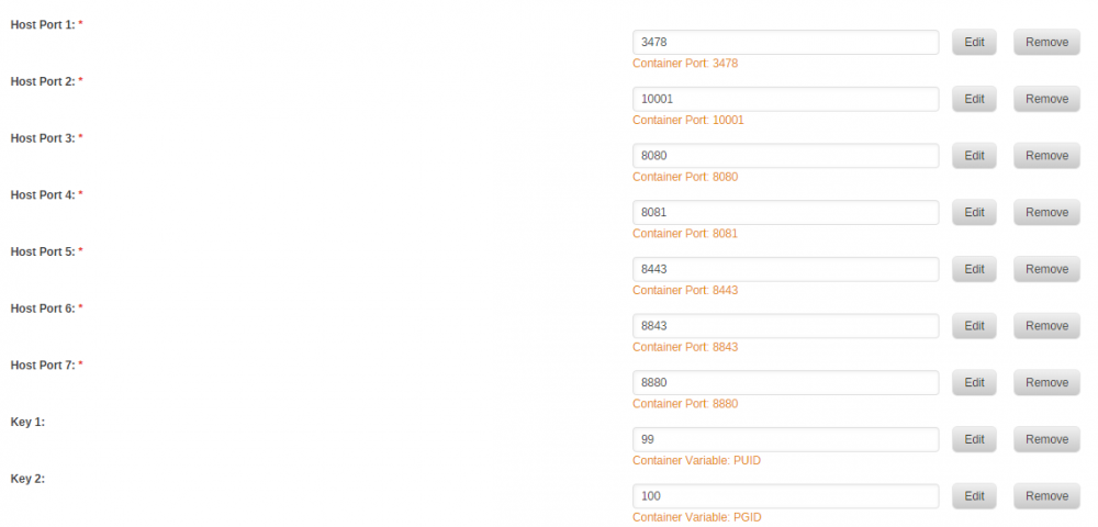

Asked and answered. You haven't added the UDP mapping that @wgstarks told you to add.

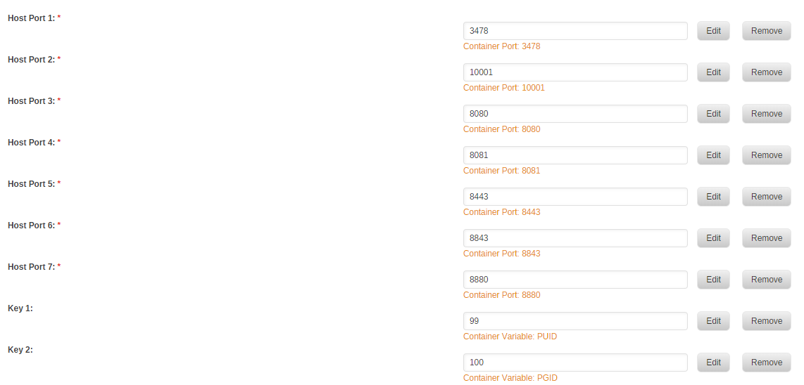

Actually... I do have this, idk why it's not showing in the list when it's in br0 mode, but when I go in to edit the container this is what's listed.
Yet when I swap over to bridge mode again it goes back to re-adopting over and over.

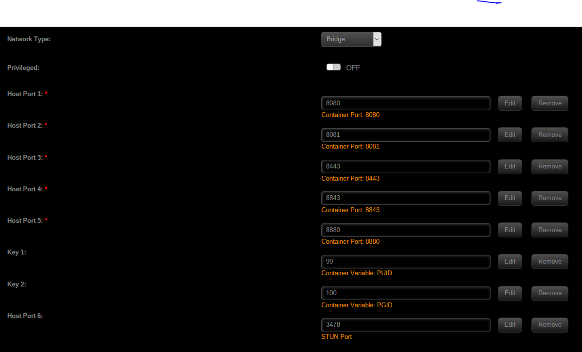

Below are my UniFi controller settings.  It is in Bridge mode and functioning without issue.
Once, I had to put it back into Host mode and re-adopt after a controller IP address change, since the devices all had an incorrect inform IP address. I made sure to SSH in and set the inform server address on each device,  just to make sure, and I have had no issues for several months since doing that.
I wish I could tell you what your issue is and how to fix it, but, I don't have the same problem.  The only difference I notice is I have no 10001 port mapping.
Edited by Hoopster

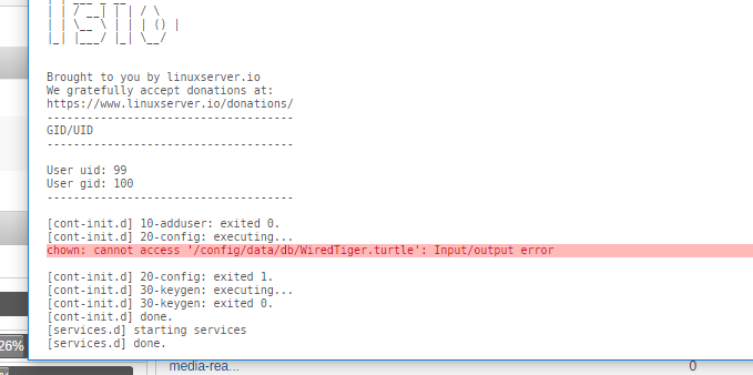

Hello,
A couple weeks ago I started having issues accessing the WebUI for this docker container (linuxserver/unifi:latest). When I look at the logs, I get an Input / Output Error:
From Chrome, it just seems to be stuck on https://IP:8443 (with the tab showing "Loading..." and the status bar showing "waiting for IP").
Here's what I've tried:
- I've removed the docker container / images & re-added
- bashed in to the container but I can't rename or replace the file from a backup
- All other containers are powered down
I appreciate any guidance.
Thanks,
Rob
Edited by rayray14

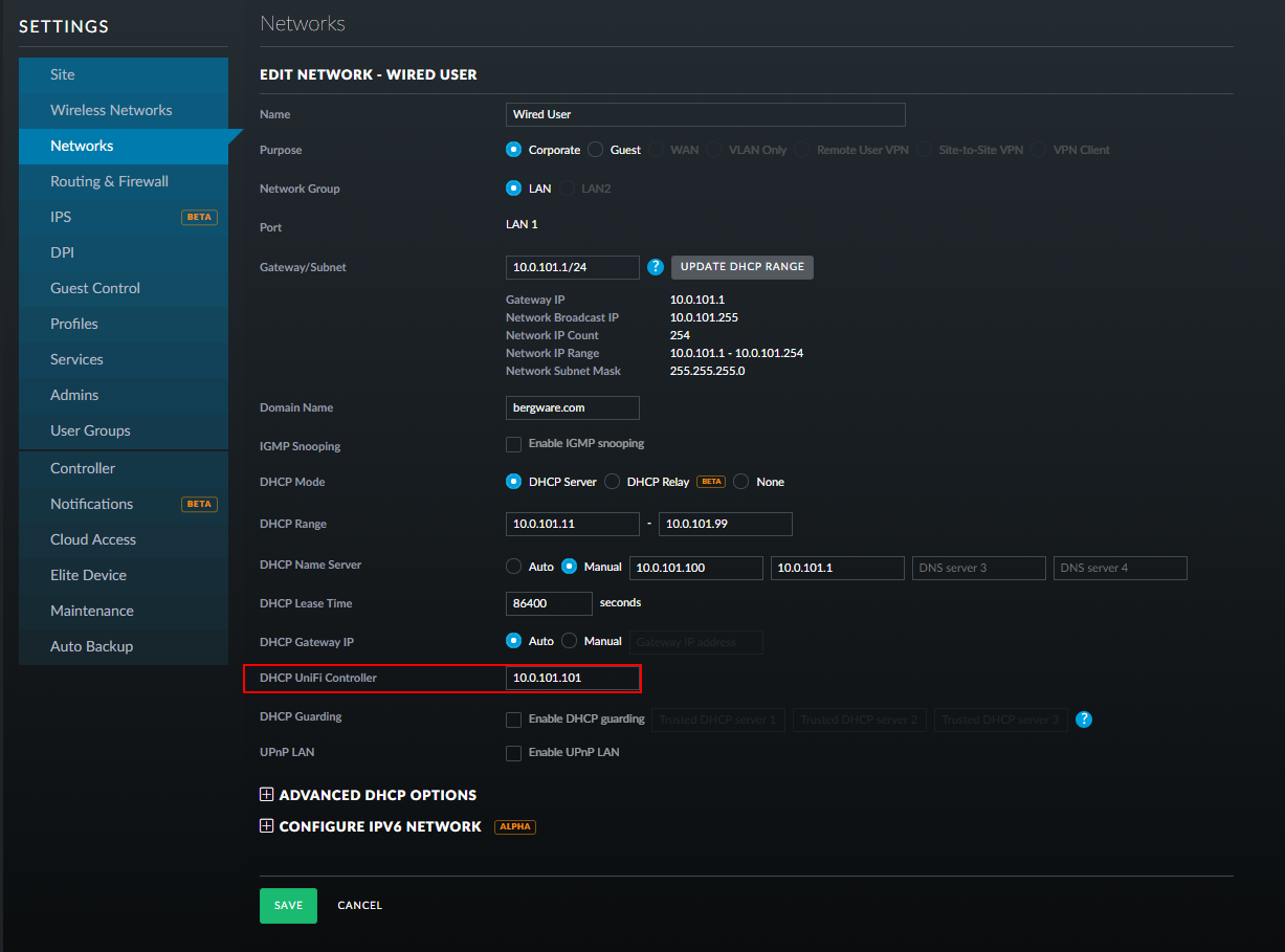

I have this container running on a custom network (br1) with a fixed IP address and my devices can always adopt. I made sure my USG router which acts as a DHCP server announce the Unifi controller address. These are my router settings.

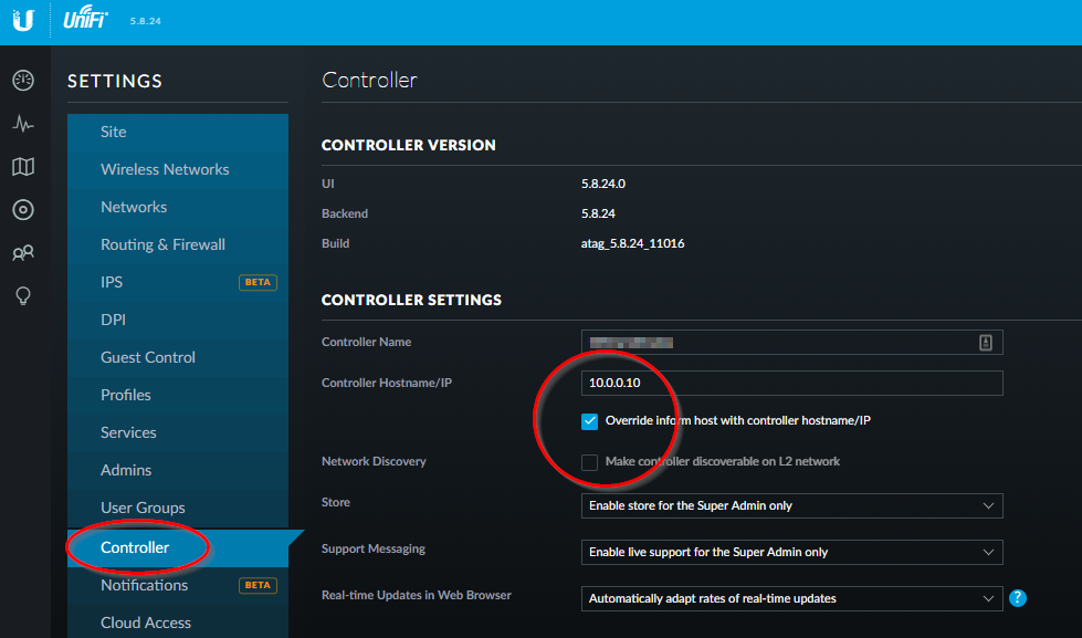

So I did some more testing today and sure enough found myself in the adopting/disconnected loop again.
 For me the key to fixing this was under the controller section. I unticked the box to be discoverable on L2 (worried it may have been pushing out the internal docker IP and not the unraid IP) and then did the tick on the box for overriding hostname/IP and set the IP to 10.0.0.10 which is my unRAID box IP.
After this and allowing devices to re-adopt everything is working in bridge.
Hopefully this post helps someone else.
FWIW - I also have the LAN network UniFi DHCP option set to 10.0.0.10 too, although I'm not sure that matters, and would only even affect those with USGs.
