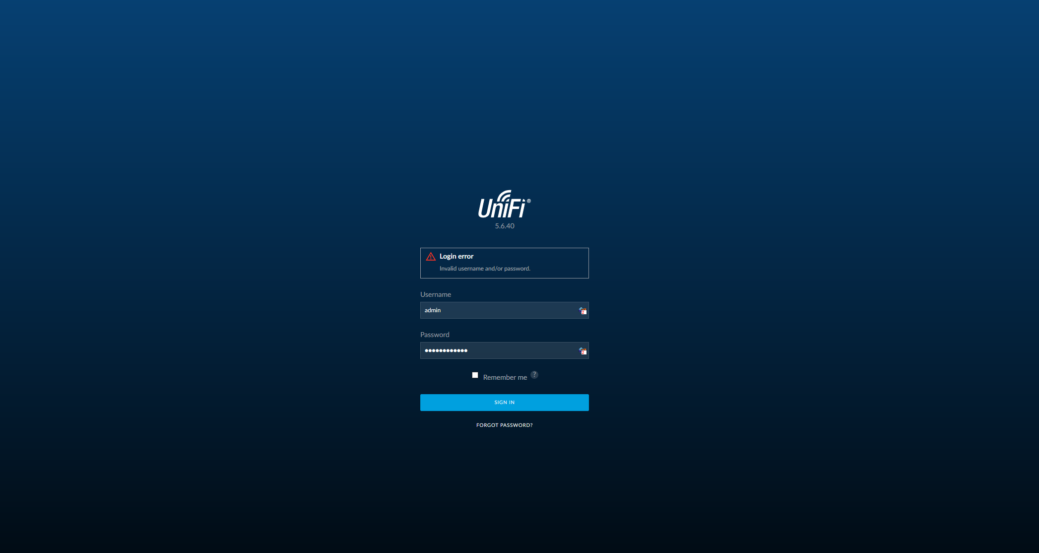

Im trying to get this docker working but im getting stuck on the initial login screen.
Is this related to the ports im using?
I don't see how ports have anything to do with wrong username/password.

i know what the issue was, and your comment helped me even tho i thought cheeky sod when i first read it lol
I had tried this docker months ago, and even though i removed the docker and ticked to remove files it must have kept the config settings in the app folder.
So i read your comment and thought "cheeky sod", then thought about it... Looked in the appdata folder after i removed the docker img and see it was still there. So i deleted it, reinstalled and now all working.
Thanks saarg
Thanks saarg
lol . It was not meant to be cheaky.
The choice you get when removing the container is only removing the images. It does not remove the appdata.
Thanks mate ;)
@Greygoose For me the username is case sensitive. admin doesn't work. I have to write it with A. Weird, but a easy fix 😁

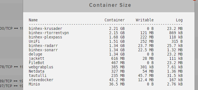

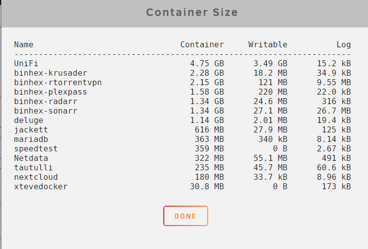

I have very high docker disk image utilitzation. I have 71% I show unifi using the most. How do I correct this? Increase size or move?image.png.6fd47befb3204d5f795da3421e23d497.png
I just installed this last week and have the same issue - Docker usage has grown significantly.
Did you find a solution to this? Should I just decrease the log retention, or is it something else?
Mine is down alot. I clean up appdata.
How do you clean up appdata?
download app CA Appdata Cleanup
to run it, located in settings > user utlities > cleanup appdata
