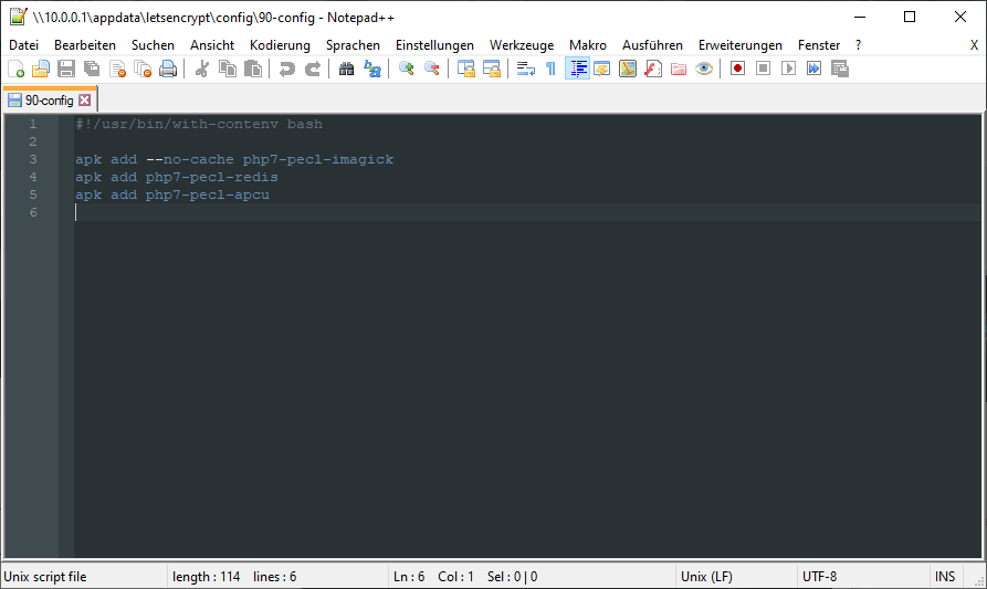

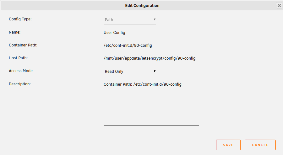

    I solved this for my Nextcloud docker with running a script via Community Applications Auto Update module. Info from http://tower/Settings/Settings/caHelp#autoupdate:   /boot/config/
