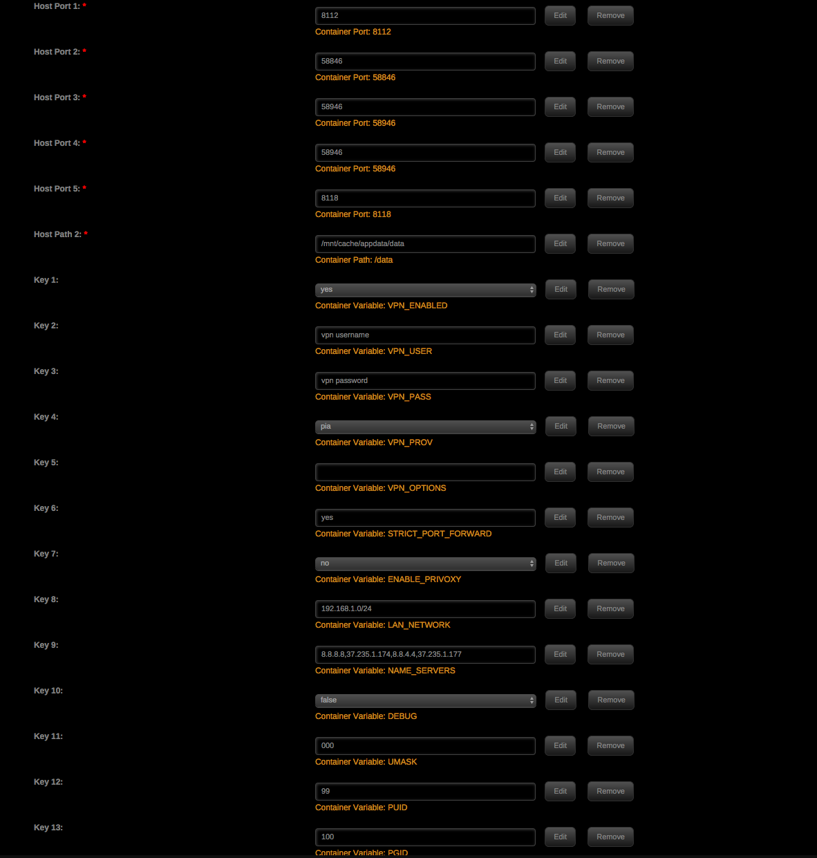

When I download the docker image some of the key fields are missing. Like the field for specifying which region you would like to use for PIA.
Any Ideas?

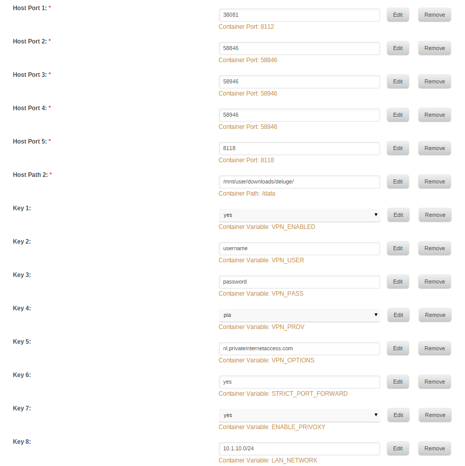

I am trying to set up PIA VPN in this container on unRAID
 I have the following files in the /openvpn/ folder (from this download https://www.privateinternetaccess.com/openvpn/openvpn.zip)
  • ca.rsa.2048.crt
  • crl.rsa.2048.pem
  • Netherlands.ovpn
I can not connect to the webUI when the VPN is enabled. I get this error in the logs
Options error: Unrecognized option or missing or extra parameter(s) in [CMD-LINE]:1: auth-user-pass (2.4.1)
I noticed the credentials.conf has en extra line after the passwords
Let me know if you need more information
Well, something is obviously wrong with the username an/or password. What happens if you delete that extra line? Are your sure the username/password is correct? Do you have any special characters in the username/password?
im using the username that PIA emailed me and I changed my password to have no special characters into it. I can connect to the VPN on their client with my login
I have deleted the extra line and restart the service but it gets readded every time
Then I don't know, better wait for the expert. But one thing you can do is to edit the container and set the debug variable to true, before you start the container again delete the supervisord.log in config, start the container and let it run a few min, then post the log here.
Edit: Be sure to remove your username/password
Edited by strike

Aaah, I see it now. You have put the endpoint address in the VPN_OPTIONS variable.. This is for advanced OpenVPN options only.  Remove that and I think you should be good to go :)
I love you
lol, glad I could help :)
