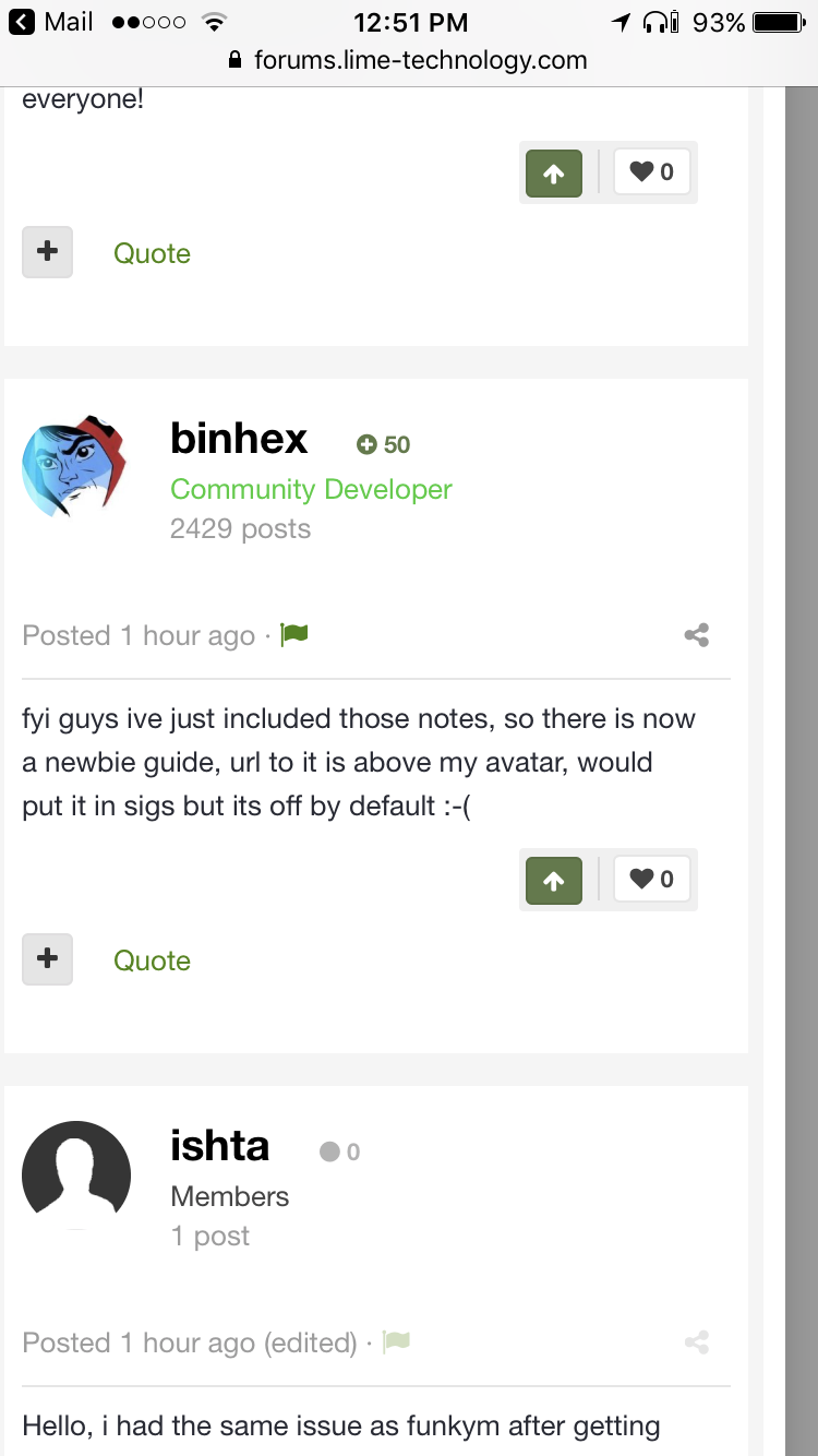

fyi guys ive just included those notes, so there is now a newbie guide, url to it is above my avatar, would put it in sigs but its off by default :-(
Any plan to add them to the GitHub readme? Just an idea. That's usually the first place I look for instructions.
Also, I don't see the link. Possibly doesn't show up on mobile devices.

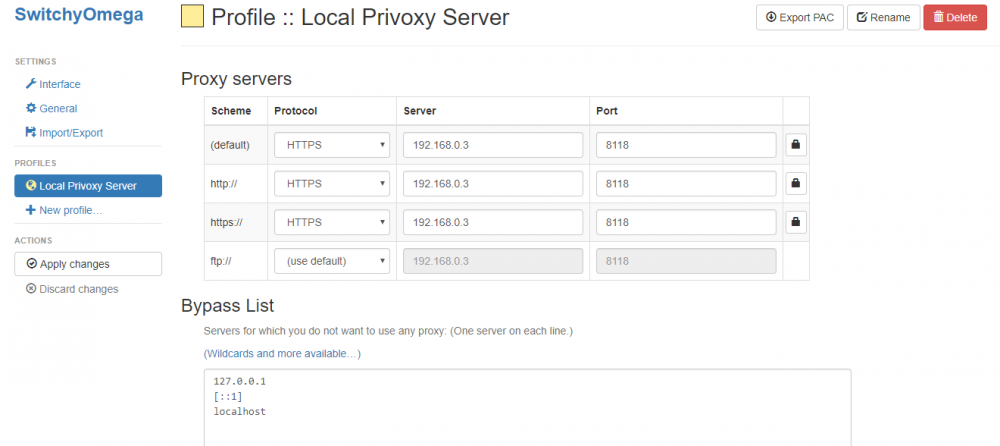

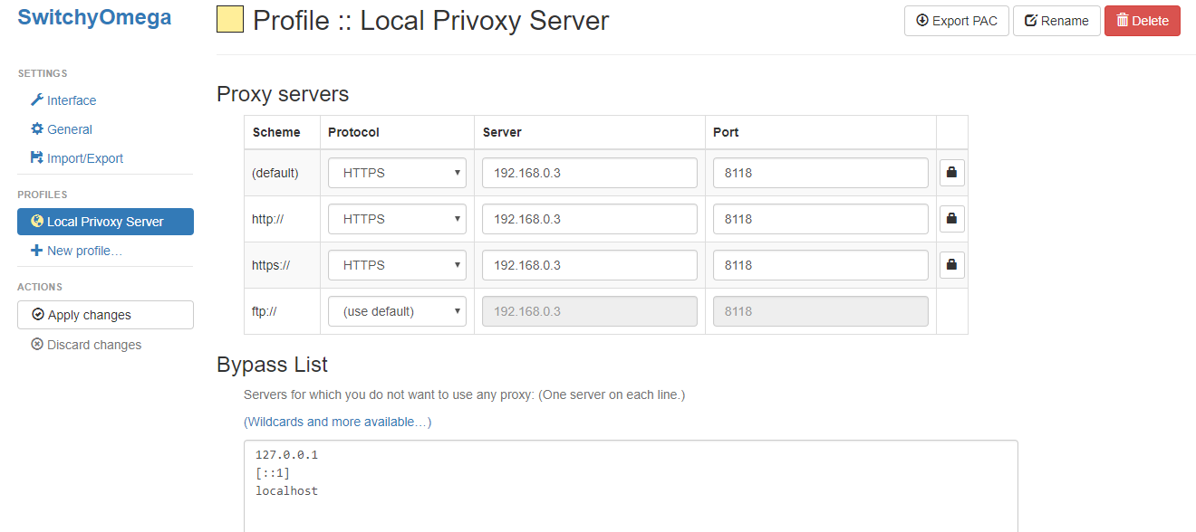

Thanks for all the great work!  I've got this up and running, except for one nagging issue -- when I stop and restart the docker, the "Label" plugin in Deluge disappears (becomes unchecked).  If I check it again, all of my label settings are still there, and other plugins I've selected (Extractor, Blocklist) never become unchecked, so I'm confused about just what's happening here....
I'm having trouble using Privoxy bundled with this.  Everything looks good, but i can't connect with it.
So my VPN works fine because i set that up first, and have been downloading with that, and then i thought i'd switch on the privoxy and to test it works connect through chrome with switchyomegeproxy extension.
I have Privoxy enable checked that the .0/24 setting, and i'm pointing the extension to my webserver ip, port 8118, but I'm timing out and its not working :(  Any clues?
Probably a configuration issue in the extension. Have you tried including http:// in the address? some apps require it and some don’t. I've never tested that extension so I wouldn’t know. What OS are you running chrome on?
I've set it to HTTPS my ip and port and to bind as default and HTTP and HTTPS just in case.  No authentication.  Can't really see much else to choose from.  Hmmmm
You're right, SwitchySharp seems to work ok, honestly I don't really care so much as long as i can quickly turn it on and off at will :)
