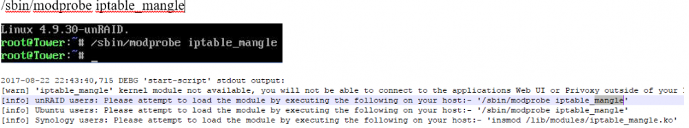

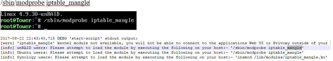

On 8/7/2017 at 5:22 PM, binhex said:
you only need to port forward 8112 if your accessing deluge using transdrone outside of your lan, you also need to have ip table mangle support for this to work (see the /config/supervisord.log)
I would like to use transdrone / web portal outside my lan, but cannot do this after set port forward with TCP & UCP protocol in my router.
I have found iptable message in the log file. Anything I need to configure?
dont do this, you dont need to port forward on your router, al traffic inbound and outbound is via the vpn tunnel.
you will always see "iptables" in the log, this is NOT the same as "iptable mangle" look for the keyword "mangle" in your supervisord.log that will tell if its loaded or not, if it isnt then you cannot access the webui outside of your lan until you fix this.
I found such message in the log file.
"[info] unRAID users: Please attempt to load the module by executing the following on your host:- '/sbin/modprobe iptable_mangle'"
Should I run this in unraid or any UI setting can do so?
that command needs to be run on the host (as in unraid) not inside the container, so SSH to unraid and then run the command exactly as below, then restart the container and you should then see in the log that its successfully loaded the iptable mangle module, then try transdrone.:-
Tried but I cannot get through after restart the server.... ?
