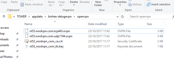

Hi all,
I'm  stuck on putting the files in, I'm running nordvpn and I have attempted the suggested fix but with no luck, I keep getting the "This site can’t be reached refused to connect."
This is the debug log for it.

any help would be appreciated and I'm still a noob at this so sorry if I missed anything stupid.
EDIT - its just started working i have no idea how but its working xD
