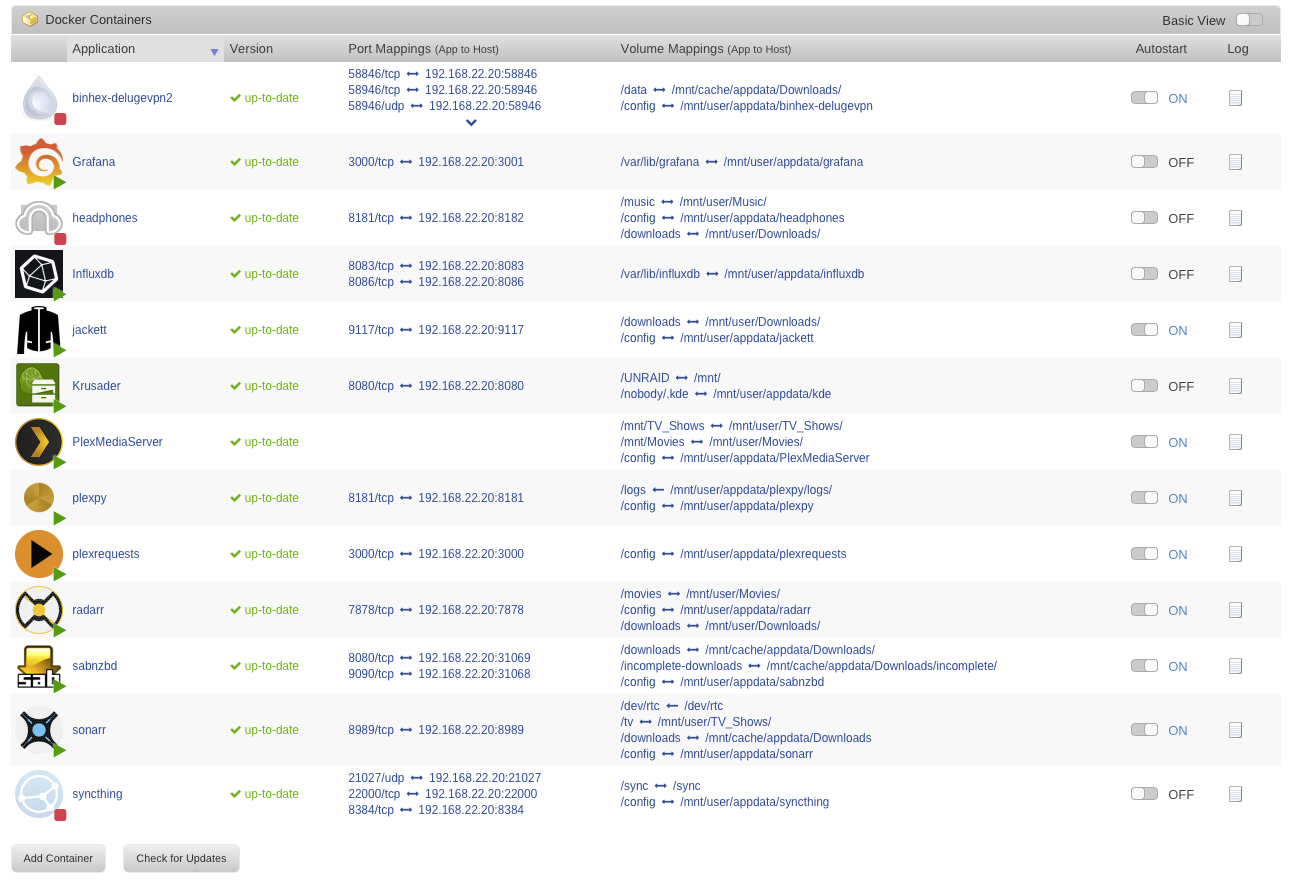

Making sure I have this clear.
you have an SSD cache, and you setup your docker's to reside on that for speed.
/mnt/cache/appdata/
you need a folder to share similar download paths for all your clients.
/mnt/cache/appdata/Downloads/
You point deluge which takes completed torrents and point it within the docker settings to /mnt/cache/appdata/Downloads/ and then within the gui, you point it to /mnt/cache/appdata/Downloads/  for finished files and Downloads/incomplete until they are finished and moved back one directory to /Downloads.
Within Sonarr you point the docker path for downloads to /mnt/cache/appdata/Downloads/
- allowing it to handle any files within /mnt/cache/appdata/Downloads/
I was getting mixed up not realizing each app was creating it's own /appdata/deluge/completed/ folder etc and I had created a folder under /mnt/user/Downloads/ and wondering why I kept downloading files, sonarr telling me they were 100% completed, but no files showing under the sonarr gui etc.
I've since moved all the files using krusader from the appdata/deluge/downloads/completed/ folder to the /mnt/appdata/Downloads/ to see if sonarr will pick up the files and move them appropriately.

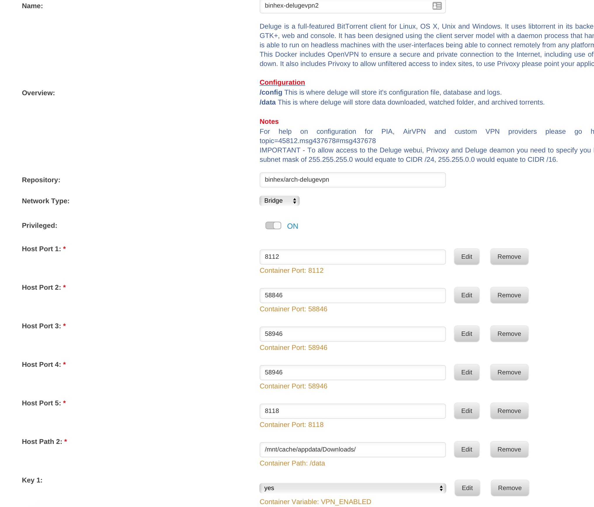

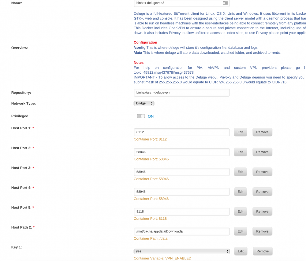

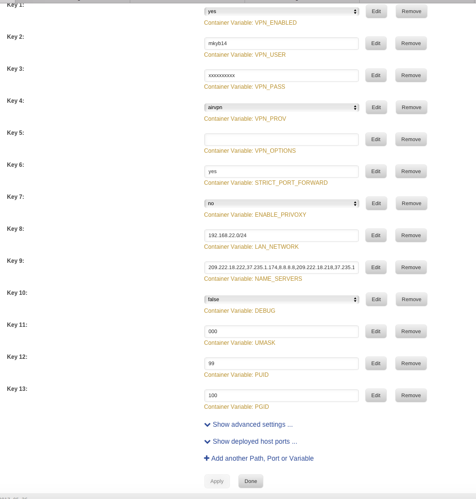

so no after changing the paths, deluge will not open...it starts and quits 1 second later with nothing listed in the logs.
Anything I can post that might help figure out why changing the docker setting path for downloads, would potentially stop this?
When you edited the docker configuration did it complete successfully? Maybe post a screenshot of the configuration.
I don’t see any problem in that part of the configuration. Probably should attach deluged.log and supervisord.log. Both are located in /config/binhex-delugevpn/. Maybe @binhex or someone else will see some issues. You didn’t include the bottom half of your docker configuration so I don’t know exactly what the /config path is. Probably /mnt/cache/appdata/.
I imagine the logs will show something.
1 hour ago, mkyb14 said:
it looks like you deleted the container path for /config as i cant see one in your screenshot (or the previous one), without this the container doesn't have anywhere to write configuration to, you either need to start again and delete the container or re-add in the container path back in.
/config only shows up under Show Advanced Settings (or Show More Settings if running 6.4)
thats not the case for me @Squid running 6.3.5 in basic view i can see /config without toggling "show advanced settings" maybe its the way i have the template defined, i might of even messed with it so its now a custom value during debug of user issues, who knows but i def can see it :S
@mkyb14 but feel free to do this to confirm if /config is show as a container path by toggling that option.
