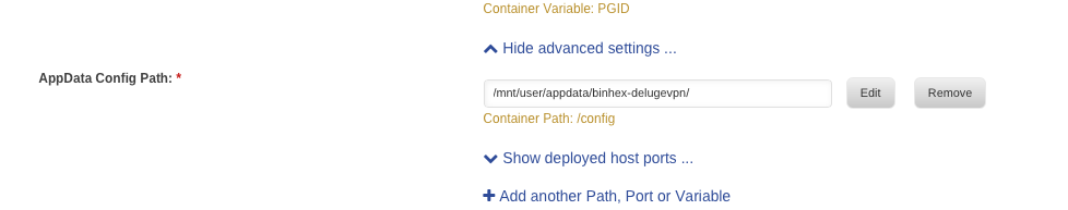

If unRaid is able to determine that the /config mapping is indeed a /config, then it automatically is supposed to hide it.  There are however template options to force it to display
never changed it, so I don't know how it would have been changed.  Here's what I have.
59f50ae350929_ScreenShot2017-10-28at3_55_02PM.png.e2683b6d4215e1a8c2e58cc1ca4b3572.png
59f50b1e29e19_ScreenShot2017-10-28at3_56_09PM.png.836ec77adb9b4ddaf0c26b8ea0a3f472.png

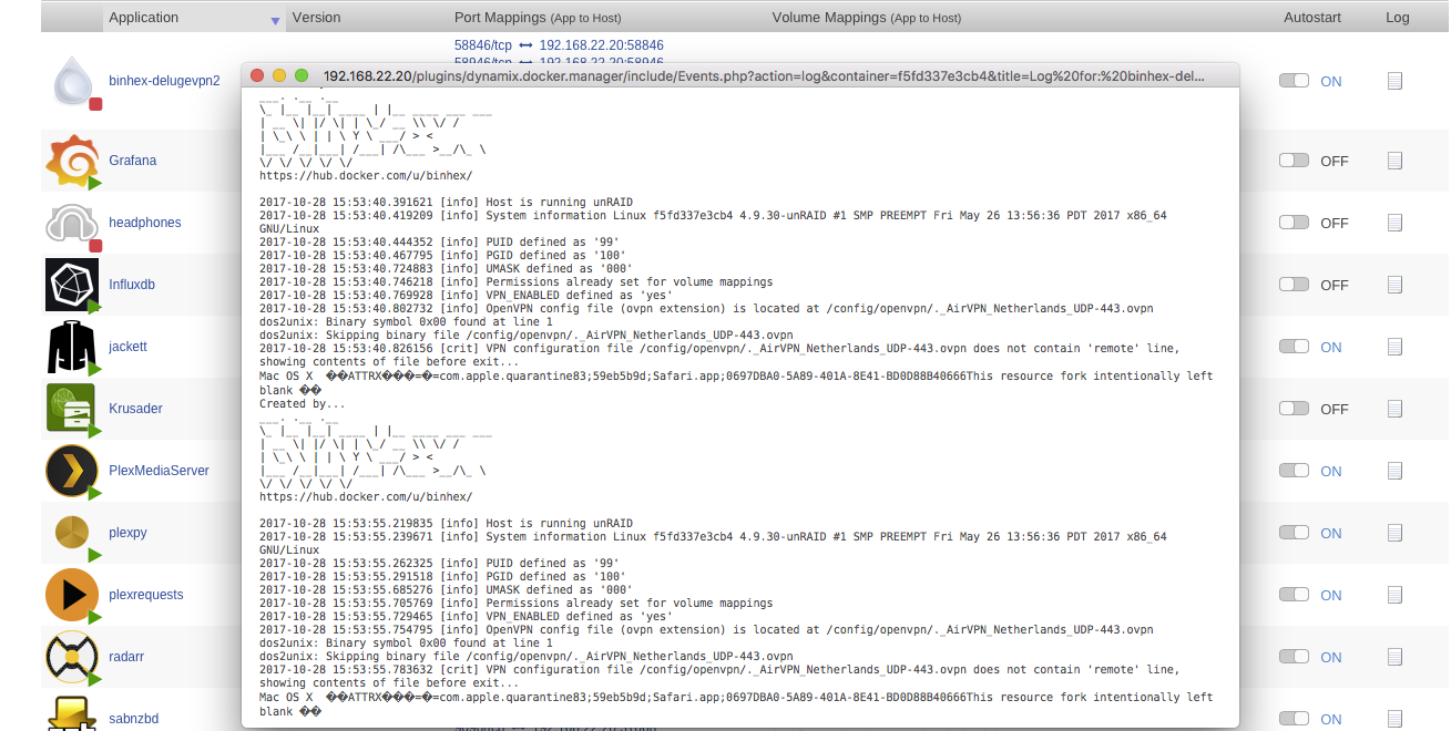

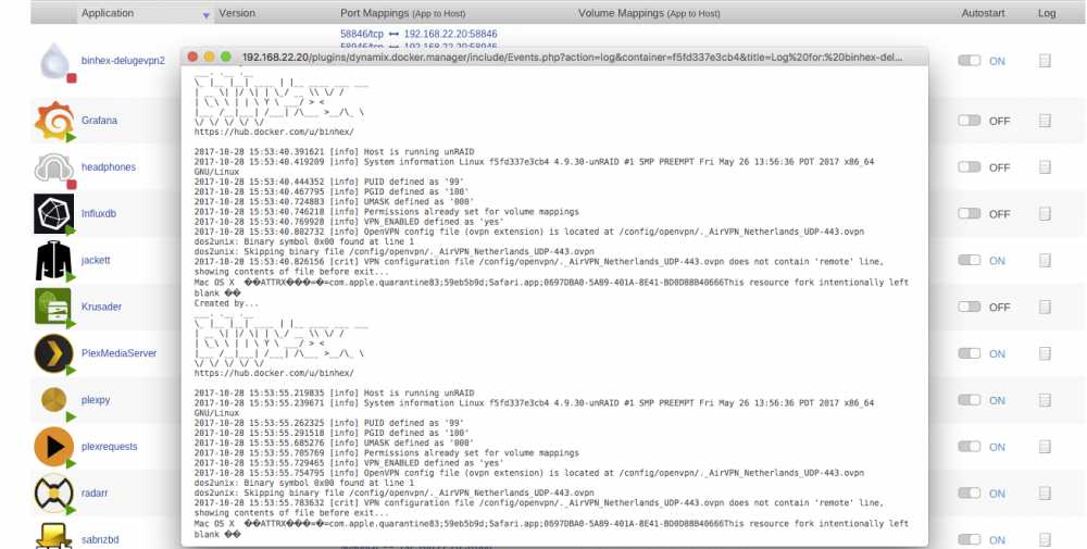

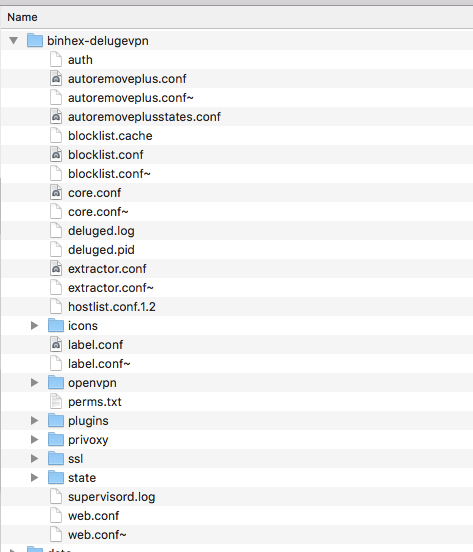

Ok time to take a look at that supervisord log file, attach please.
Also please paste output of command "docker logs nameofthecontainer"
2 hours ago, mkyb14 said:
think that's everything.
supervisord.log
Your AV software on your mac has decided the ovpn file was a virus (go figure) ive seen this is several times now, infact its even in the FAQ its that common. so you need to firstly reconfigure your av to stop it trying to quarantine ovpn files, once you;ve done that then delete the old one and replace it with a re-downloded ovpn file from your vpn provider.
I don't have any, that's what's funny.  unless apple has built something in, I'm gonna have to google this.  it worked before.  let me blow the container away and try this again.
it looks like its built into os x:-
Apple computers running OS X do have a default security program called XProtect built in.
blowing away everything will fix it until XProtect finds your ovpn file and craps all over it again, you need to fix this otherwise you will get hit again.
So what I don't get in all this, is how apple is involved if I'm immediately moving this file to unraid, and it works once start a fresh docker.  Apple shouldn't even be involved at that point since it's on a completely different system.
It's working now, see what happens with a few start and stops.
if you open the ovpn file to edit it or view it using your mac then your apple is involved at this point, as the XProtect app will then scan it, decide its a virus and quarantine it, as long as you dont go near that ovpn file with your mac then yeah you will be fine, but if you accidently forget and try to open/edit the ovpn file or even copy and paste it from your mac to unraid then you may encounter the issue again, trust me its def your mac.
Edited by binhex
ok, I'll not mess with it.
