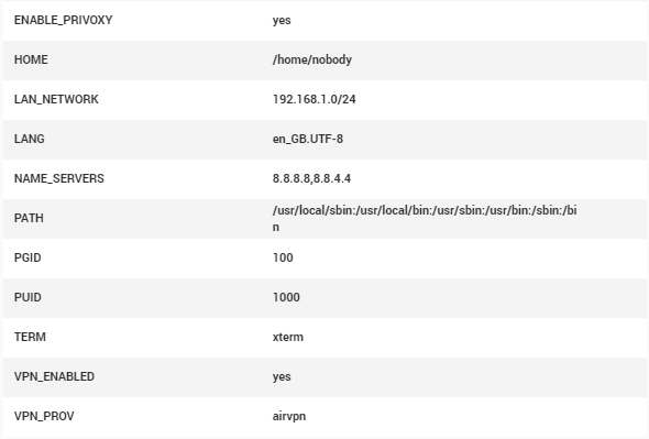

Ive been using your DelugeVPN Docker for about 8-9 months, When i notice that none of the torrents was downloading. So checked console, and for some reason VPN keep connecting & disconnecting. I seen that i was running a outdated version (Deluge was 1.3.14 or 1.3.13 cant remember), thinking that maybe the problem (a bug with that version that i have not experienced before now?) So i took screenshots of Docker conf., removed docker and reinstall with the newest version (1.3.15+2+g38d7b7cdf-1-12) reentered all config setting. And started docker UP. Same thing VPN keeps connecting then disconnecting. but this time i cant even connect to deluge webui (i was able to before the upgrade even with vpn acting up). So maybe that VPN Server acting up? tryed 3 more servers (endpoints) still the samething even tryed 2 more servers with different ports (was using 433 so tryed 53, 1194) I'm a (mid grade) noob when it comes to linux/docker so that was all the basic troubleshooting i did. Im hoping you can help me out.
Server Notes
Running on Qnap 4.3.4.0370 Build 20171103
Bridge Mode
Container ip/subnet 192.168.1.200/255.255.255.0
Run container in privileged mode = Checked (was the only way i could get docker to work in older version)

Here's a new log file. i hate to keep bugging you, hope you dont mine
deluged.log
supervisord.log
15 minutes ago, Alacard said:
i cant access deluge from web access or from daemon via 58846
so what url are you using to connect to deluge?, copy and paste your docker run command, or whatever it is you use to define the container on a qnap device.
For Web access using http://192.168.1.200:8112 but for the  daemon via 58846 i use deluge gui connection manager to connect to it
For the run command.. If you talking about the command it use when starting the container its "/usr/bin/tini -- /bin/bash /root/init.sh" but if you talking about the command it use when making the container for the first time. not sure on that one i maybe able to track that down by checking the logs
Edit: OMFG... found out the problem... for some reason qnap made a bridge with the subnet of 255.255.0.0 -.-, so i just corrected the subnet (255.255.255.0) in the config file and restarted docker/container. just sent them a bug report that its overwriting the settings you set with a default subnet of 255.255.0.0 on container creation. Sorry for wasting your time like that >.<
Edited by Alacard

OH man...Ok I'm trying to install this to use with airvpn which I just purchased, having never used a vpn before.
I'm a very casual user here and only installed Emby Server so really not sure what the heck I'm doing...
I'm trying to install this docker and am on the advanced page.  The only items I managed to figure out was to put in my IPVanish id and password, and select airvpn for vpn_prov.  My lan network I'm a little unsure about.  It seems to default to 192.168.1.0 but mine is 192.168.0.x...do I put 192.168.0.0?
After that I'm totally lost.  I've gone through the general vpn thread and quite a few here but in the end it's just a lot of confusing info that's going over my head.
Would anyone be kind enough to help me out with the next steps...in easy to understand English? ;-)
