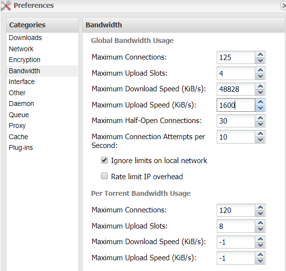

I need some help on this one.
So ISP plan is 500mbps down and 20mbps up.  Which is megabits right?    Deluge is is KiB/s which is Kibibytes rights?
So 500mbps = 24414KiB/s and 20mbps = 2441KiB/s...right?
So does the below look ok for deluge

That looks fine, you have left some room for other traffic.
